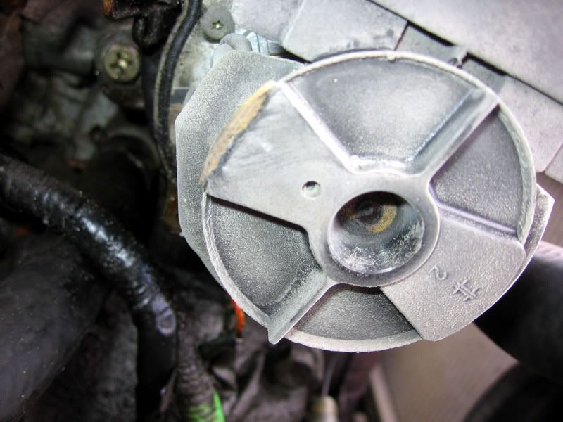

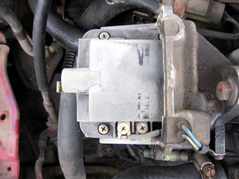

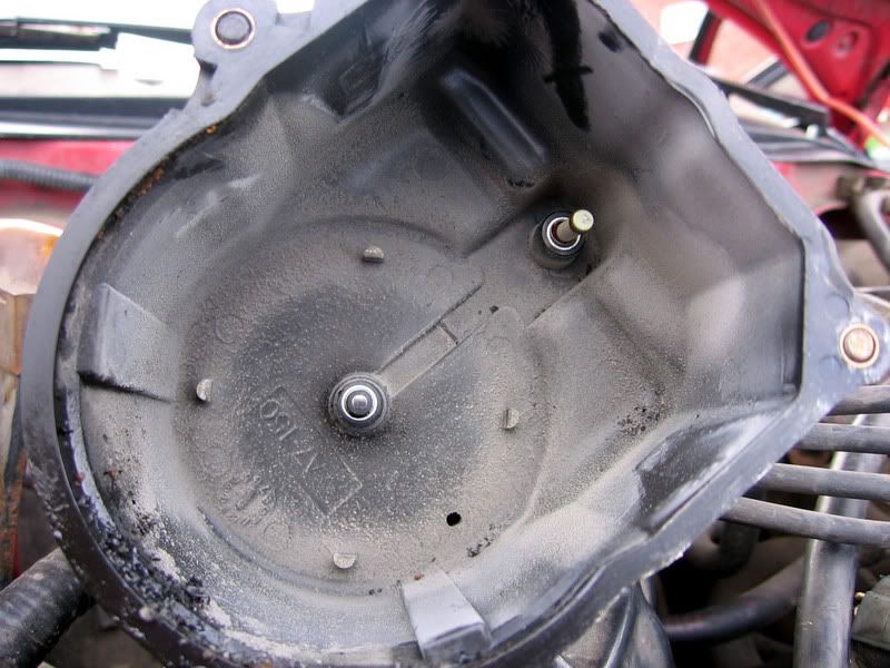

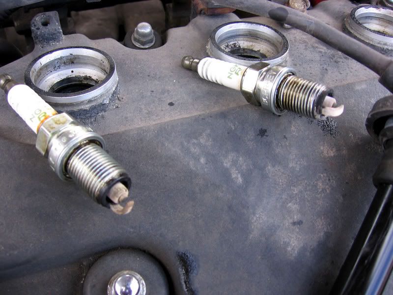

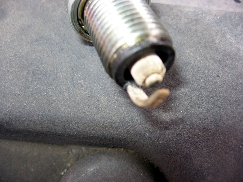

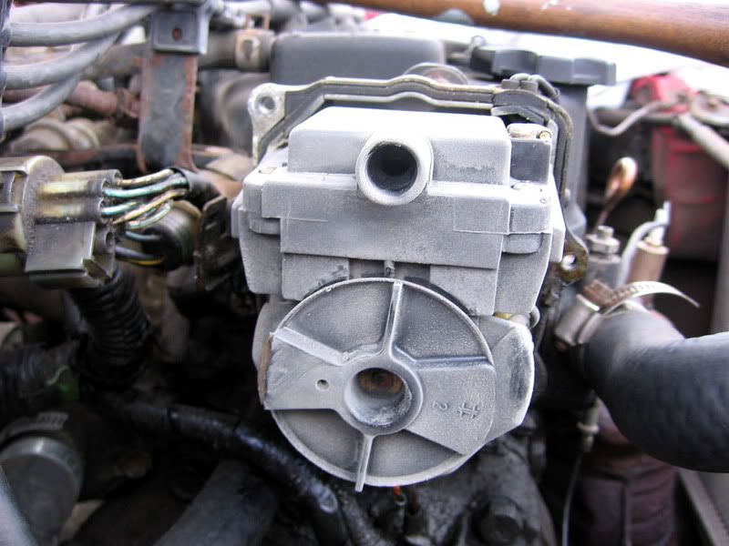

So...it's very cold out today...and I decided to continue to try and get the dizzy cap off bore I went back to tackling the alt. I finally got the dizzy cap off...bottom screw stripped and took out the spark plugs...well three plugs...one is siezed and I have to figure out how to get that out too:
http://i134.photobucket.com/albums/q97/JasonL_album/dizzy1.jpg
http://i134.photobucket.com/albums/q97/JasonL_album/dizzy2.jpg
http://i134.photobucket.com/albums/q97/JasonL_album/dizzy3.jpg
http://i134.photobucket.com/albums/q97/JasonL_album/dizzy4.jpg
http://i134.photobucket.com/albums/q97/JasonL_album/dizzy5.jpg
http://i134.photobucket.com/albums/q97/JasonL_album/spark1.jpg
http://i134.photobucket.com/albums/q97/JasonL_album/spark2.jpg
What now...what am I looking for now that I have the dizzy cap off?

CRXperiment
11-04-2006, 03:54 PM
Well you cant really "look" for anything. I guess you can check the screw on the rotor (the round thing sticking out of your dizzy), but it seems straight to me. Instead of looking you need to test for spark like we asked you to, that will determine if you have a problem in your distibutor. We've already told you how to check for it. You can also try turning the crank to see if your timing belt is intact.
PS: you might want to replace you cap/ rotor, they look grungy and oxidized.

So I took off the timing belt shrowd and here's what I saw:
http://i134.photobucket.com/albums/q97/JasonL_album/tbelt1.jpg
http://i134.photobucket.com/albums/q97/JasonL_album/tbelt2.jpg
http://i134.photobucket.com/albums/q97/JasonL_album/tbelt3.jpg
http://i134.photobucket.com/albums/q97/JasonL_album/tbelt4.jpg
The timing belt didn't just break...it vanished...it's gone...completely!? In the last picture it appears as though the spring is still in one piece so that's good...
So...is this a hard fix? Now what? (Aside from the obvious of buy a belt)
Jason

johnb16a2
11-20-2006, 03:45 PM
It can be time consuming but not difficult but you will need to make sure everything is at top dead center and you will need a service manual. And there is a chance you bent some of the valves and I'm not sure how to check for this unless aside pulling the cylinder head off.
