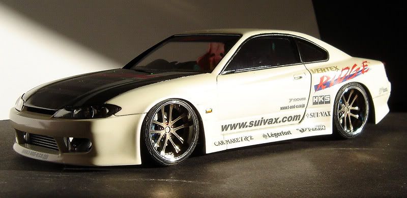

:D Hello again,
the suspension is done, the first time I have added some brake lines... I´m very happy, all 4 tires are turning very well, steering works very good :icon16:
The rims are painted with Tamy smoke, only the "Kränze" decals to the center I have to add.
On the boot I had to fill some molded dents :rolleyes:

The Silvia becomes my personal trouble record holder :icon16: , I had many troubles with the new bonnet, but now itīs completed. The body wears new paint, needs new decals and clear cote.
http://img216.imageshack.us/img216/1520/dsc04512qb9.jpg
http://img227.imageshack.us/img227/3571/dsc04513tp5.jpg
http://img227.imageshack.us/img227/5789/dsc04514bf0.jpg
http://img216.imageshack.us/img216/8819/dsc04510rx6.jpg

Risko
12-11-2006, 05:02 PM
Thank you for your kind words!
I mixed the paint from Testorīs white primer, a little bit of Alfa Romeo automotive pearl paint (sorry, no code- itīs the blue/silver to gold one) and some of Flagship Pigment Powder purple.:smokin:
