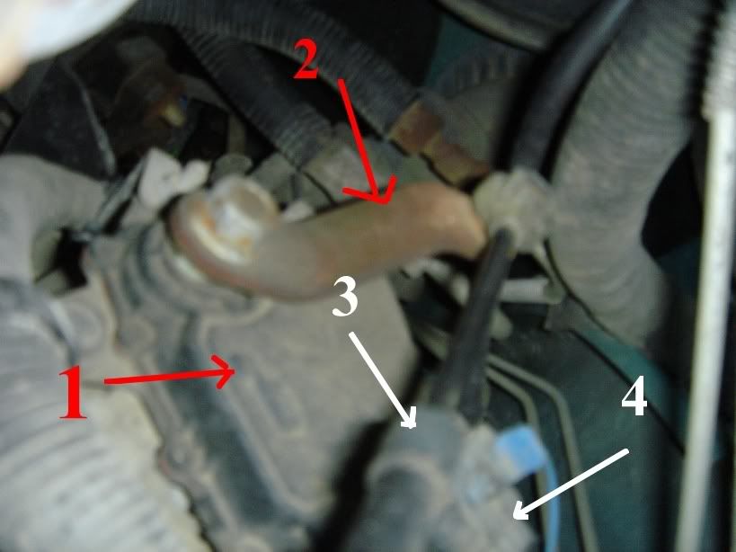

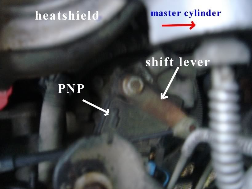

This is what controls your back up lights.
Heres a pic.
To locate the PNP, standing on the driverside look down next to the fuse box, past the throtle body/air intake.
You will see a red cap to the left, thats the trans fill, to the right(rear of car) you will see the shift lever and PNP switch.
PNP plug lever (http://i28.photobucket.com/albums/c242/xeroinfinity/auto%20odds-ends/PNPpluglever.jpg)
#1 park/neutral postion switch
#2 Shift lever
#3 shift cable
#4 PNP wiring harness connector
PNP shiftlever (http://i28.photobucket.com/albums/c242/xeroinfinity/auto%20odds-ends/PNPshiftlever.jpg)
Heres a pic.
#2 Shift lever
#3 shift cable
