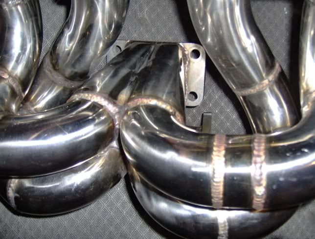

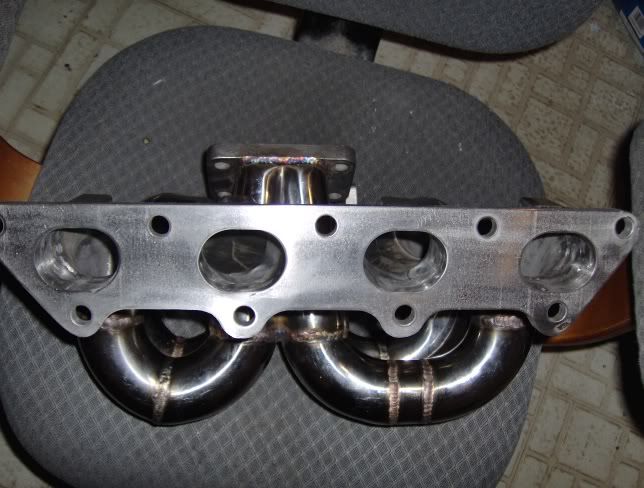

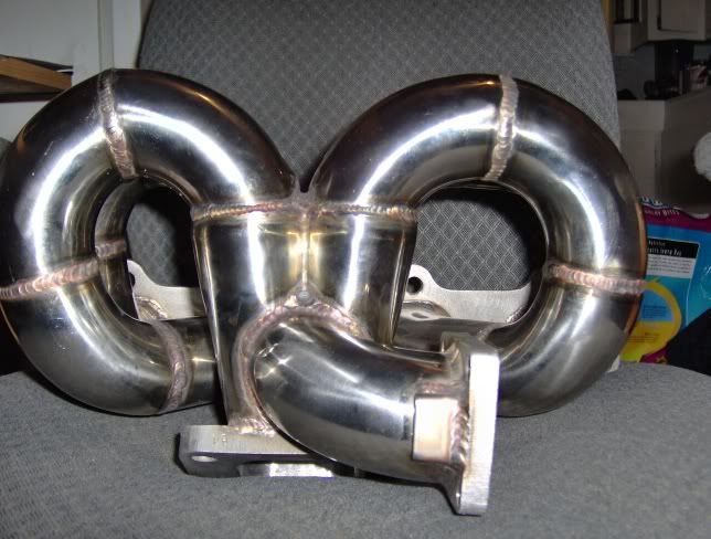

well i got this thing back because the guy didnt do any work that was in the deal SO i have a brand new tube mani flanged for a T3 turbo and external dump...
make offers on it.. low balls will be slapped! ;D
but no offer will be over looked
pics coming just gotta find them
[quote author=flip4g63 board=fsp thread=1161057688 post=1161057753]http://i43.photobucket.com/albums/e388/Flip14b/HPIM0798.jpg
http://i43.photobucket.com/albums/e388/Flip14b/HPIM0799.jpg
http://i43.photobucket.com/albums/e388/Flip14b/HPIM0802.jpg
there it is... make some offers
