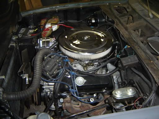

Bio}{azard
10-21-2006, 02:59 AM
'74 Vega, '77 231 Buick V6
New cam,
High compression pistons
Four barrel intake manifold
Edlebrock carburator
Single core alluminum radiatior
and duel electric fans
6 months old but it looks like this

UncleBob
10-21-2006, 04:33 AM
Get a fan shrowd on that thing. That'll double your cooling effeciency right there.
That is the most common grevious error people make on cars. Fan shrowds are extremely important for air flow over the radiator.

Remember, that pic is old, and we now have duel Electric fan and a single core radiator.

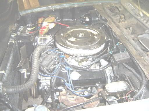

TheSilentChamber
10-23-2006, 12:53 PM
I lightend the picture that you linked so that we can accually see the radiator. You have room to fit a massive radiator in there, your fan is a good 3-4" away from the radiator.
http://img.photobucket.com/albums/v608/thesilentchamber/Engine.jpg
From just looking at the picture, air one could be reason also, the highest point in the system is the bend in that top hose.
