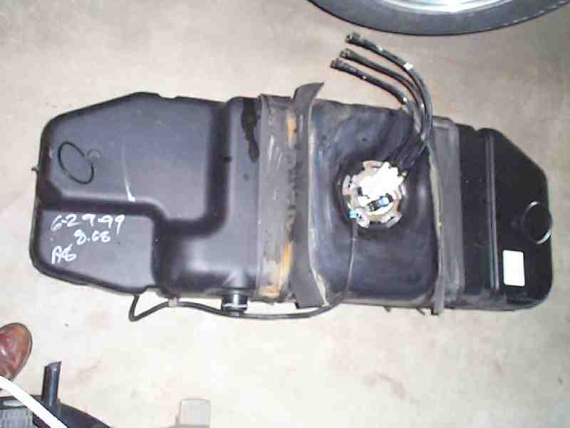

I know I need a fuel pump replaced - Just wondering if anyone has ever cut through the floor to gain access to replace it?? I have done this with a lot less hassle with a 97 Chevy Venture van. Any info. would be appreciated...

I would avoid cutting the floor on an Astro. Most of the rigidity of the floor will be compromised. Besides, it's not that tough to drop the tank - Even the large one:
http://www.wwdsltd.com/files/AstroFuelTank.jpg
Then pull the top unit:
http://www.wwdsltd.com/files/AstroTankTopUnit.jpg
Then replace the pump and connectors:
http://www.wwdsltd.com/files/InTankUnit01.jpg
