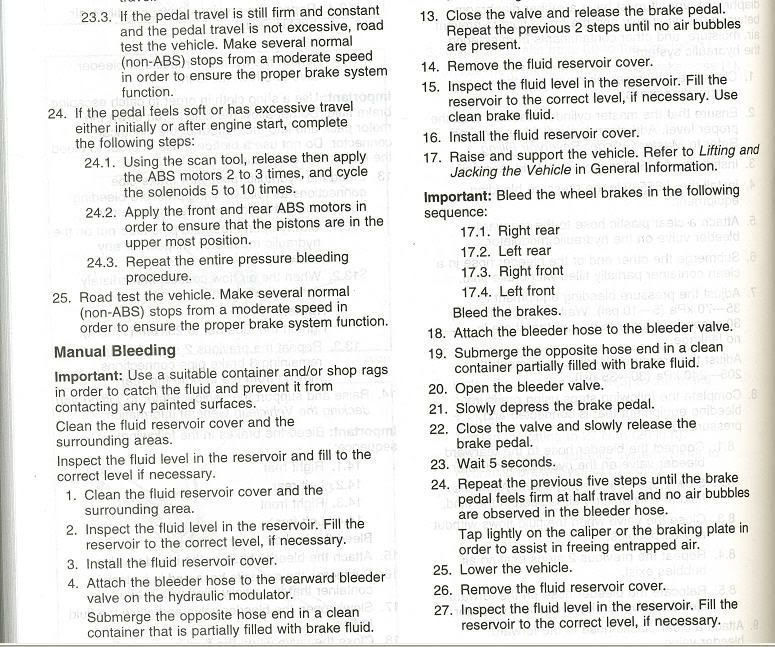

it starts half way down the page , then 5 on the next page, follow the numbers
text from factory manual for model yr 98
http://i53.photobucket.com/albums/g80/viking_03/page1.jpg
http://i53.photobucket.com/albums/g80/viking_03/page2.jpg
let me know if U need more
