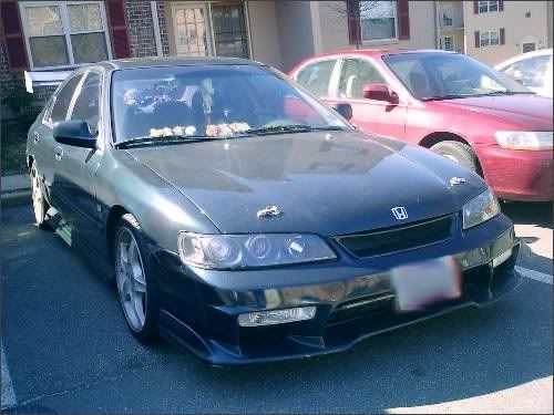

I put halos on my car and it took about 1 hour because I stripped some of the plastic screws.
http://i18.photobucket.com/albums/b125/hahakenny/Accord.jpg
http://i18.photobucket.com/albums/b125/hahakenny/MyCar.jpg

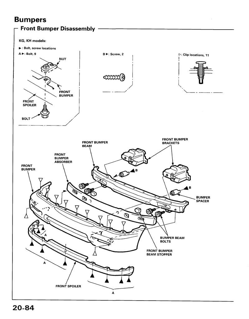

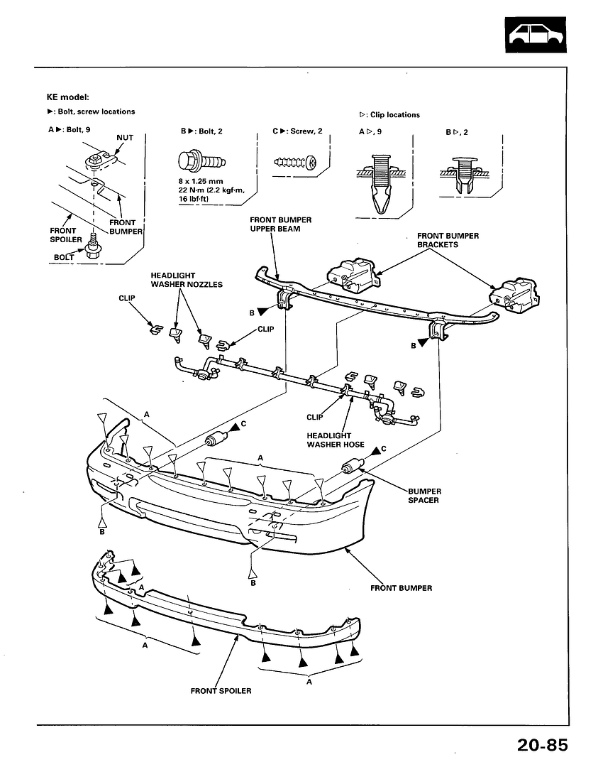

I have a 95 Accord that I need to remove the bumper (it's kinda scraped up, twisted, and broken thanks to my teenage daughter meeting the rear of a Nissan):crying:. How many pieces make up the bumper assembly (cover, reinforcements, braces, etc.)?? Does anyone have an exploded illustration of the bumper components?

hahakenny
10-09-2009, 01:05 PM
RonMur
10-10-2009, 01:43 AM
Thanks.
