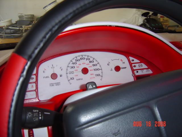

I used it for my gauge bezel. The inside of the cluster there. It was really smooth when compared to the rest of the car... aside from that, it took a little while longer to dry, but looks good. Take a look for yourself. http://i15.photobucket.com/albums/a386/Derk_eliso/DSC00414.jpg
