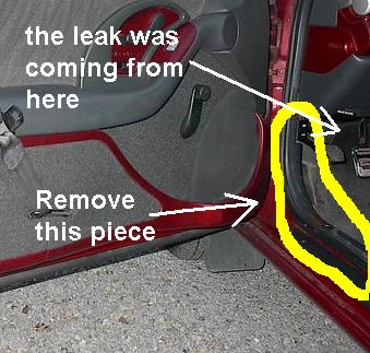

i had the exact same problem. The seal between the floorboard and firewall was old and had a really fine crack in it. Almost not visible. I resealed it and it fixed the leak. Caulk will work to fix it. You gotta take the plastic piece off the side of the car (see pic below) then peal the carpet back from behind the pedals back towards the seat. Also while i was at it I tore all the foam padding out because it made the car smell like old, wet shoes.
the plastic piece actually goes back a little farther than the pic shows but its the best i could do. Careful not to break it but it is very flexible.

you wont need to cut the carpet. See my first reply. I included pictures.

That's fine if it is that seam. What needs to be determined is how high up the firewall material is wet. The tendency for these vehicles to rust out and through by the drivers side drain plenum will cause water to run down from a much higher point.
