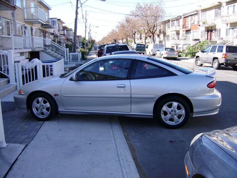

im telling ya my doors have play and, they both have the same play..unless its normall for 2002 to have a little play... mind you the hinges were never greased.. and, well iv reached about 49000kms... can it be that its normall they have a small play like that.. of about an 8th of an inch..
the play is 8th" up and, down
