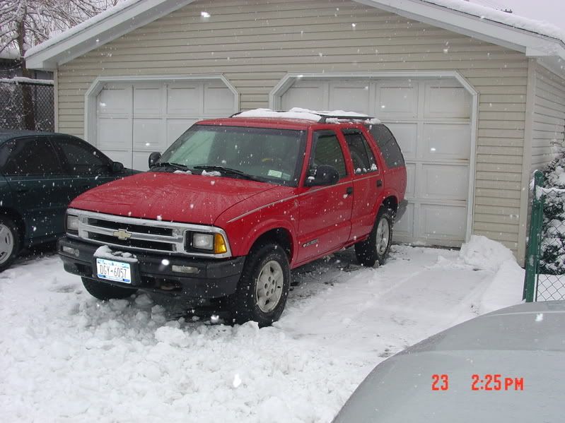

GirlBear
10-05-2006, 02:49 PM
what year Blazer?
1996
http://i11.photobucket.com/albums/a200/Girlbear/Picture025.jpg
Man winter is right around the corner again. How Depressing.

alblogg
10-05-2006, 09:54 PM
1996
Yeah dummie me sorta figured out the year span of your Blazer after I looked at the picture.
