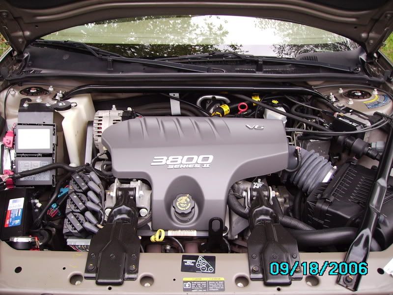

Its front wheel drive... I know I could've got more out of my car if I sold it myself, but me and my dad did not want the hassle of trying to sale it, and we dont have room for it to just sit. But I have to say that the motor in my car is effin sweet, and it only has 25,000 miles on it!!
http://img.photobucket.com/albums/v307/iamsodamnconfused/IMG_0584.jpg
the 3800 is nice :) but the supercharged 3800 is nicer :grinyes:
please_pimp_my_rde
10-18-2006, 12:37 PM
Too bad my Impala didn't come with it:mad:
