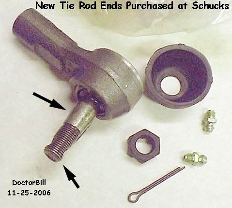

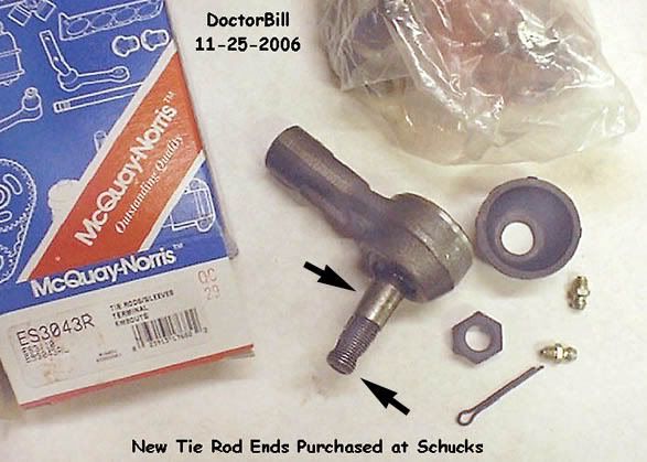

I changed the front wheel bearings on my '93 Geo Metro about a year ago.
Don't remember much except it was a bastard because I didn't know what
I was doing - as per usual!
Getting that rod out of the wheel assembly took beating on the pin which
deformed one of them. I had a Forked Tie Rod Removal Tool which was
totally useless - or I didn't know how to use it - one or the other....
I bought new ones to replace the old ones, but never put them in yet.
I got the old ones back in and just left them that way so that I wouldn't
need to get it all re-aligned. It has worked.
But it made one Hell of a difference once I was done! Silent bearings....
http://i70.photobucket.com/albums/i86/DoctorBill_SCC/Metro%20Head%20Rebuild/Fin-NewTieRods-1.jpg
http://i70.photobucket.com/albums/i86/DoctorBill_SCC/Metro%20Head%20Rebuild/Fin-NewTieRods-2.jpg
I essentially bashed the threads in on one Tie Rod - but luckily I got the nut
to rethread upon assembly.
I would put some anti-seize lub on the tapered portion with the arrow to hopefully
allow you to remove them later on.
You will need to take the wheel assembly in to a shop to have the old bearings
pressed out and the new bearings pressed in. I wouldn't try it yourself!
