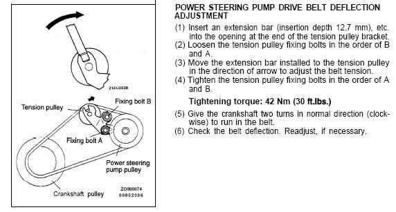

... the power steering belt. We pulled it off last night and put a new one on, that took us almost 2 hours cause mitsubishi is very crafty how the do their tenisioners and all that but we had to figure it out first.
2 hours?
if you had the service manual, it would have helped.
for future reference
http://i57.photobucket.com/albums/g236/Linebckr49/3000GT/engineaccdia.jpg
http://i57.photobucket.com/albums/g236/Linebckr49/3000GT/pwrsteeringbeltadjustment.jpg

That would have helped. It would have also helped if my dad wasnt so stubborn, he just kept looking at his engine for comparison (he has an 07 yukon xl lol) instead of going on the internet. When we finally figured out that it was the top bolt to swivel on instead of the bottom that made things go really fast. O yeah and that 2 hours included us going to get the belt too lol.
