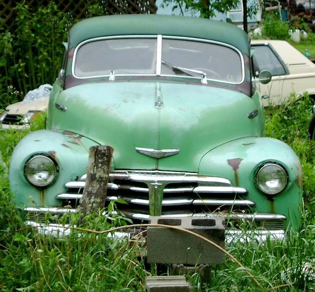

The car is here
http://img.photobucket.com/albums/0903/pressroom/Old%20Cars/48chevy.jpg
The car is here
Blue Bowtie
09-26-2006, 09:02 PM
2-door sedan? Looks like a good project.
