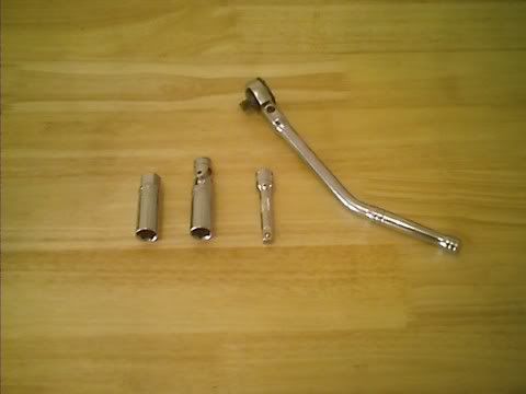

Ahha - just bought one of these last month and never thought to check access to the plugs (oil filter is a breeze).
bnaylor: what would you consider being the "right spark plug removal tools"?
I might as well get them early before the Christmas rush :)

Here a pic of what I use. The ratchet is made specifically for spark plug removal.
http://i5.photobucket.com/albums/y186/lizzywiz/sptools.jpg
You can get ready made kits with these tools at any popular auto parts store, Sears, Snap-on, etc.
Also, I have the special socket to remove the 02 sensor in the way which has a slot for the 02 sensor wiring harness. When I replace plugs I clean the 02 sensor as a preventive measure all at the same time.

Thanks bnaylor
And I wasn't kidding about Christmas - wife asked me what I wanted this week and I'm going to print out this photo and tell her to "hit the streets"
