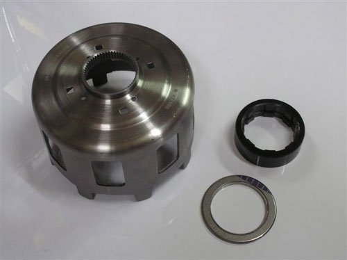

Blue Bowtie
09-24-2006, 03:08 PM
If the transmission started to slip some miles ago, the reaction sun shell hub is probably not sheared off, but has no spline teeth left to it, like this:
http://72.19.213.157/files/ShellCompare.jpg
I would normally suggest using the factory replacement part, but in this instance I would disagree. Any factory remanufactured or new transmission will invariably have the SAME REACTION SUN SHELL. AFAIK, GM has YET to address the real problem that the rest of the industry has known since 1983 - These things are plain CRAP! Mine went at 61K. Further, the factory reman will likely have a five- or six-disc clutch stackup in the 3/4 clutch, whereas a quality rebuild will have EIGHT discs with full-thickness steels. The same thing happens with the factory low/reverse clutch and direct (forward) clutch.
Further, do not use your original torque converter unless it has under 45K and can be flushed completely. Even 45K miles is a push if the vehicle has been used for hauling/towing or driven harder.
If it were mine, I'd rebuild it myself and select the components individually to make it as durable as possible. That would probably include a five-pinion planetary set, and maybe the low ratio planetary set (2.66:1 first gear) in a higher performance application.
silicon212
09-25-2006, 12:41 AM
I thought GM addressed the sun shell issue with the 4L65E - at least that's what some local transmission shops around here (AAMCO and Cottman, to name two) have told me.
I'd still go with a Beast if at all possible.
