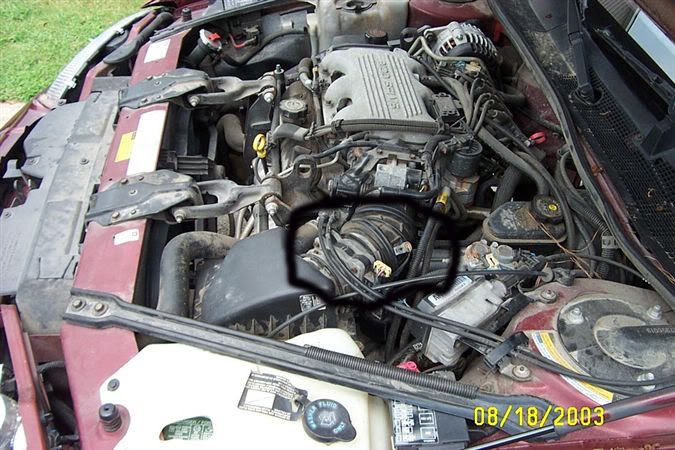

Its in the parking lot at the store..(about 4 miles from me :frown: ) so in the picture where i circled is where i spray the starting fluid?

Just above where you circled, you'll see a hard plastic line that pops into the air intake tube and goes back toward the EGR valve. That is the easiest access point to spray in the starting fluid. Go easy with the starting fluid, just a couple of quick bursts. To much can cause new issues.
