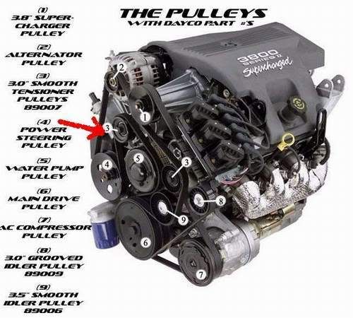

For the main serpentine drive belt system you are supposed to wrench the tensioner which has a 3" pulley and a 15mm bolt holdling it on located below the alternator.
See pic below which shows the serpentine and supercharger belt system. Red arrow points to it. #3.

Okay, that helps a tremendous amount. First off, let me say an unconditional thanks for your help because this information is not available anywhere else. So, that pulley does not swivel like the supercharger belt tensioner does. With the supercharger belt, you wrench it and it will pivet in which obviously loosens the belt. I will loosen the bolt on the tensioner pulley and finish it tonight. Out of curiosity, how does that work if the pulley doesn't swivel? When you loosen it, how does it cut slack in the belt?

Actually the main tensioner does swivel/pivot similar to the supercharger tensioner. Counterclockwise for the main serpentine tensioner and clockwise for the supercharger tensioner. The bolts in each pulley are threaded differently.
You do not need to remove the main tensioner pulley but just put a 15mm socket or wrench on it. Depending on the condition of the tensioner it may need some extra force. If you are having problems moving the main tensioner and cannot remove the drive belt then it may have a problem. Tensioners on the '97 models and maybe into '98 were flaky.

Interesting. Again, I appreciate your help and I'm sure I'll have this alternator in tonight thanks to you. Getting the belt off was the only problem for me. After that it's two bolts, an electrical connection, and what looks to be a ground wire connected to a petruding bolt. Thanks man!
