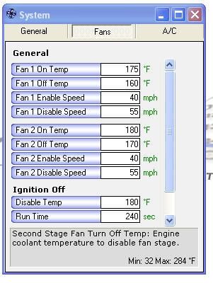

you might also want to get the car scanned, the temps that the fans come on can be set in the PCM, sounds like yours might be set too high. On my Impala they were set to come on at 230 F . I set them to both come on at 180. Since the fans are coming on with the AC I do not think it is a relay or anything like that.
Could you tell us how you set the fans to come on at a lower temperature?

http://i53.photobucket.com/albums/g80/viking_03/TEMP.jpg
you need a tech2 scan tool or a device called a power tuner. I have the power tuner. It is software that runs on a laptop and through a cable that hooks to the ALDL talks to the car computer using the OBDII gateway.
Thanks, where can I purchase this software and whats the cost?

At first the it seems expensive, I look at it as an investment. I was experiencing alot of pinging, which overheats the engine, and damages the engine. After taking out some timing and adjusting my fueling I have more HP and an getting 25 - 27 mpg with an LA1 Impala. My case was extreme, the Chevy dealer was not doing anything. I had to do something. I am glad i got it.There are several , there is DHP Digital Horse Power , tHERE IS SUPER CHIPS PREDATOR, and after carefull consideration the one I finally chose, HP Tuners. they have the standard and inhanced . The inhanced you can use a wideband 02 + other stuff, the inhanced has data logging , the standard you will need a notebook with usb v2, the inhanced you can use a notebook too if you want
