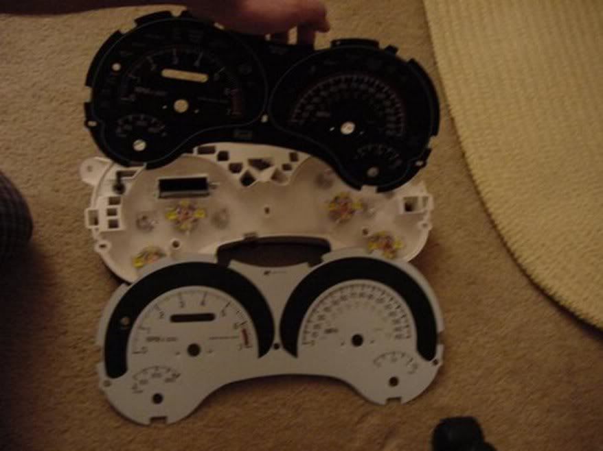

xeroinfinity
09-18-2006, 10:19 PM
Heres a pic of the inside of the cluster, with the gauge face off.
Gauges open (http://i28.photobucket.com/albums/c242/xeroinfinity/SeCond%20Hand/whitefacegauges.jpg)
LeDs last for like 10k hrs or something :dunno:
They usually only blow if they get to much juice.
