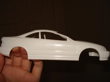

I just got my JDM DC2 Integra today that I bought from Hong Kong. The problem is that the guy didn't package it really well and the roof ended up getting smashed. Can anyone tell me an easy way to fix it. It didn't crack, the plastic is just smashed at the window area.

Can you post a picture of the damage? You will get better advice if people can see the damage it will be easier to advise what to do to fix it.

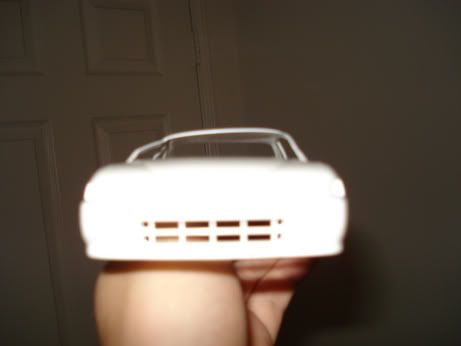

I pushed up on the roof to fix it a little. It was worse then that. I also noticed that the right center pillar is not boken off.

That looks like a tricky one to resolve.I had a similar one some time ago with a Hasegawa Subaru Legacy though it was not as bad as yours.I fixed it by pushing it back into place and using some very thin plastic card to brace it from the inside,secured with liquid cement.Maybe some of the other guys can help you out with some suggestions as well.I hope it is not the same guy from Hong Kong who I have had recent dealings with on E Bay.I never even received the model I bought from him.But if it had arrived in the condition yours has then maybe it would have been a waste of time anyway.I hope you can fix yours though,best of luck with it.

I agree, use thin sheets of plastic on the pillars so they don't interfere with the windows. I hate how the pillars are so weak on those, i have recieved two like that. Good luck

For the pillar, I sink the part in hot water (don't leave it alone!) for a moment. Then I took it out, re-bend it and drop into cold water... I ended with something less destroyed than it was...
