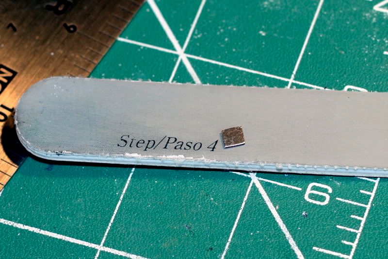

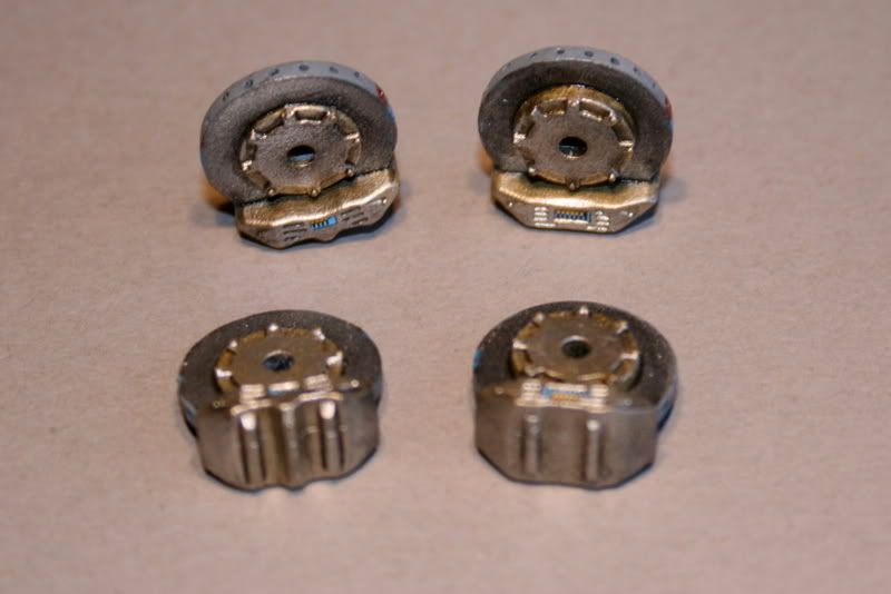

First up, how to drill perfectly spaced ventilation holes in your brake disks. At first I thought I could just eyeball it... wrong :banghead: What happens is that when you turn the drill it moves around and so you end up with un-even spaces. So, I marked out 2mm lines on some Tape with a ruler, then stuck it on the part. I then used my thinnest drill (0.3mm) to drill a pilot hole... then moved up a drill size at a time until I was at 0.6mm which seems to me to be the rightsize of hole. This definitely works as a system but unfortunately I didnt ensure that all the holes were in the middle of the brake disk :banghead: Oh, well, at least no one will see them when the wheels are on :grinyes:
http://i40.photobucket.com/albums/e250/billypee/Jordan%20191/IMG_0599.jpg
I found this 4 step file in Boots the Chemist (UK cosmetics shop) and it is fabulous. Four different grades on one stick. It is supposed to be for girls nails but hey, I thought I would give it a go on mine :grinyes: Wow, you should see how shiny my nails are after a good buffing and a coat of Tamiya Model Wax! :rofl:

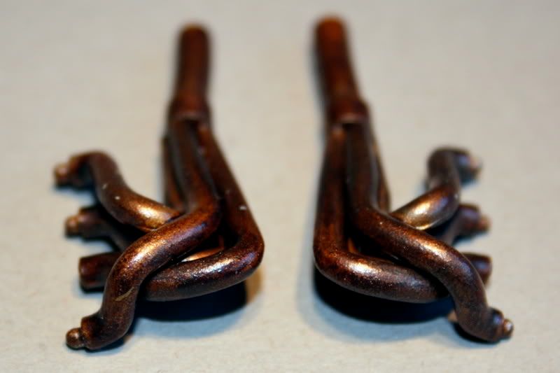

Just a small update to keep you all interested. All the parts that I showed you primed in the last update now have, at least, their base layer of colour paint applied. The majority of the parts are black and for that used Halford's Satin Black straight from the can. It's a really good match for X-18, and goes on just great... one of those paints that looks to heavy and wet once applied and then dries a lovely semi-matt and reveals all the detail. However, I have managed to complete a few of the non CF parts, so here is a couple of photos to share my observations.
First up, the exhaust system. The instructions say to mix X-11 (Chrome Silver) with X-6 (Orange) in a 1:1 ratio. So I thought I would and see what that gave me... the answer... gold. It is very similar to X-12 Gold Leaf. I know from the reference photos that the exhaust needs to look essentially brown but I applied the mixture anyway. In order to tone down the gold, I gave the exhaust a very heavy wash (hardly thinned down) of Citadel Color Brown Ink. This combination results in a lovely "bronze statue" sort of finish... very nice if you are modelling a bronze statue but not if you are trying to model the exhaust system of an F1 car :grinyes: . So I applied a third layer to the exhaust, this time Gun Metal from the Tamiya Weathering System. I rubbed this on quite heavily with the foam applicator and it produced a finish that looks 99.9% the same as the reference photos (I couldn't believe my luck). It also adds some much needed texture too. The photograph makes the finish look more glossy that it is in real life, most likely due to taking it in-doors using a cheap flash and some halogen lighting. Bottom line, I will be doing future 'brown' exhaust systems this way. The only thing that remains is to add some blue for heat stress... but thats on order from HLJ so will have to wait.

I have also completed the 4 brake disk and caliper assemblies. As you guys know, the all-in-one assemblies on most of Tamiya's F1 line up suck. I "umm-ed and arr-ed" about using after market replacements or scratching something better myself but eventually decided that the kit stock items would do (given the level of detail on other parts of the car and the fact that I will be displaying this kerbside). The callipers are painted in X-31 (Titanium Gold), the centre of the discs at X-12 (Gold Leaf) the disc surfaces are X-10 (Gun Metal), and the disc edge is XF-66 (Light Grey). All washed with Citadel Color Black Ink thinned down quite a lot. Once dry, it was lightly rubbed with the Silver from the Tamiya Weathering System. I used the F1 Specialities blue heat sensor decals on the callipers... these needed to be cut to shape. You will also notice that I drilled the ventilation holes in the edge of the disc and applied the blue and pink heat sensor paint. Overall, I am actually very impressed with how these came out considering that they are the stock items.
http://i40.photobucket.com/albums/e250/billypee/Jordan%20191/IMG_0665.jpg
Your comments are most welcome.

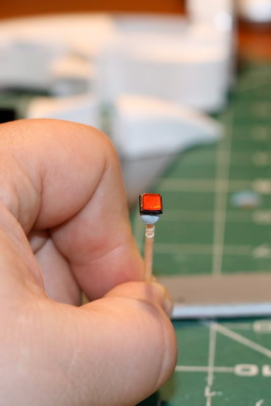

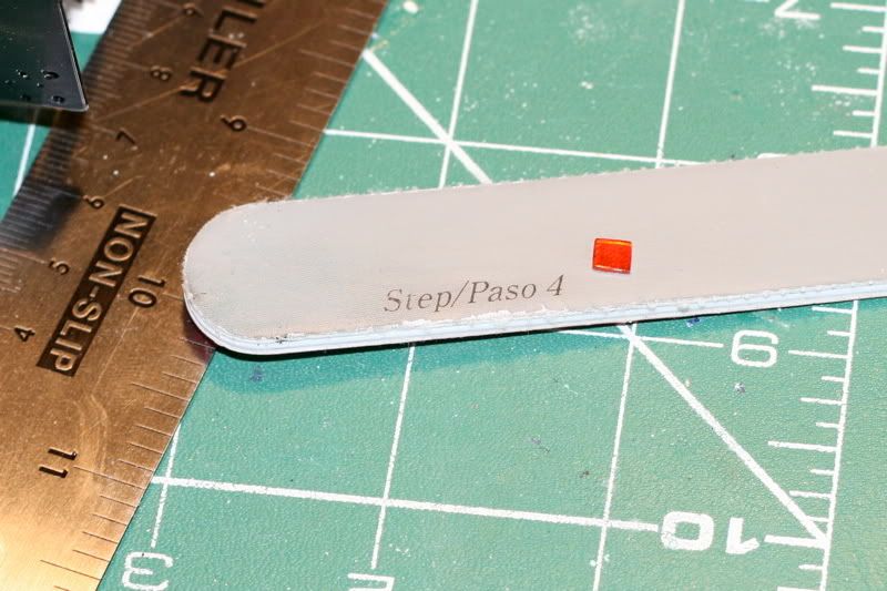

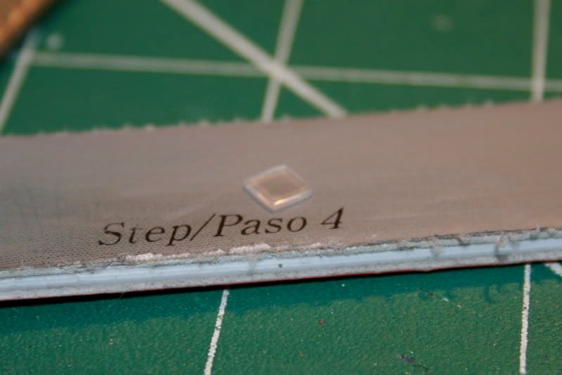

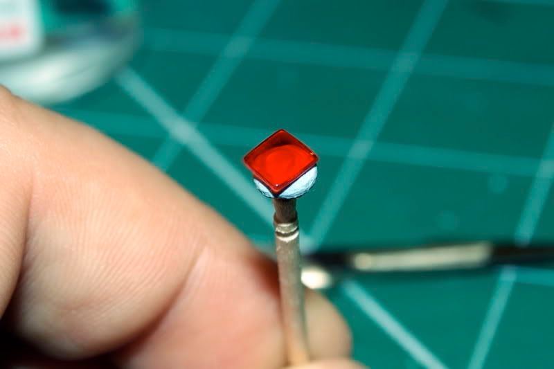

I removed the lens from the kit piece, leaving the black housing remaining. I then cut a piece of clear sprue from my FW11 left over sprue to the right shape. I then polished it with the 4 step nail file I spoke about in a previous post.
http://i40.photobucket.com/albums/e250/billypee/Jordan%20191/IMG_1111.jpg
I stuck it to a toothpick with Blutac and painted it with clear red. No thinner required. It goes sticky and looks like a boiled sweet.
http://i40.photobucket.com/albums/e250/billypee/Jordan%20191/IMG_1117_2.jpg
Once dry (obviously) I applied Bare Metal Foil (BMF) to the underside. The silver really makes a difference and allows the lens to catch more light. You could use X-11 but the BMF is much easier.
http://i40.photobucket.com/albums/e250/billypee/Jordan%20191/IMG_1209.jpg
http://i40.photobucket.com/albums/e250/billypee/Jordan%20191/IMG_1211.jpg
I then glued it to the housing I saved from the original kit.
http://i40.photobucket.com/albums/e250/billypee/Jordan%20191/IMG_1213.jpg
And there you have it. Looks much better than just painting some plastic red... IMHO.

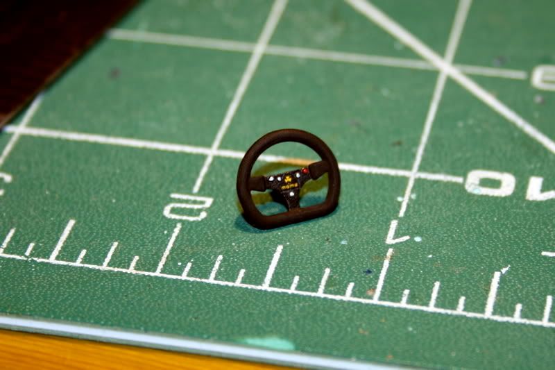

Also, here is the steering wheel complete with the original Momo decal as the S27 decals omit it.
http://i40.photobucket.com/albums/e250/billypee/Jordan%20191/IMG_1214.jpg
