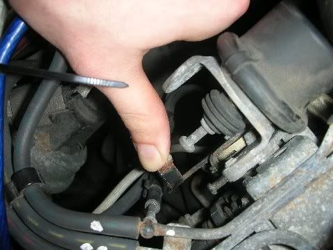

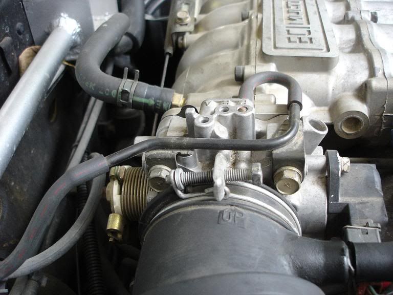

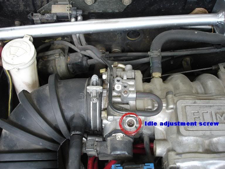

i took some pictures of the throttle body, cable, and surrounding areas. please describe in what picture you are talking about.

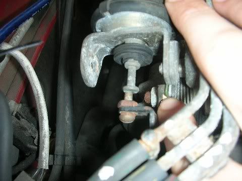

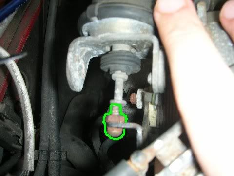

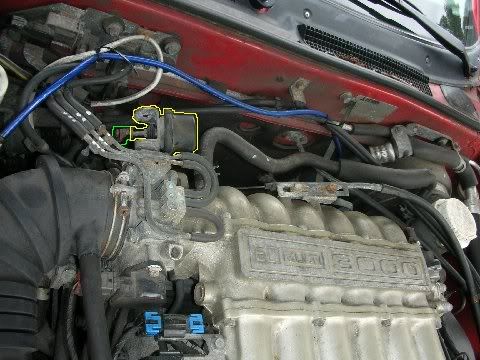

gas pedal is connected to the cord, which is connected to the piece surrounded in green. when i push the pedal, it pulls the cord and the (green) peice off the (yellow) piece. when i let off the gas the green contacts yellow and slowly allows the green to fall down to idle position. (i'm guessing by looking at it)

def thought that was the idle screw, since if it wasn't as long the car would idle lower, becuase it would make contact when it was farther and the intake was closed off a little more.
http://i115.photobucket.com/albums/n287/gismojames212212/8.jpg
but anyway the yellow piece looks like its the culprit for the rpm jumps, i wish i had a movie of the throttle being let off and it slowwwly depressing down to its compressed position. hence when i shift : let off the gas and push in the cluth, the throttle isn't closed off like it is at idle yet and the engine is still adding gas and air, making the rpms jump, until it depresses more, cutting off air/gas, and slowing the rpms again.

So wait, when you pull them apart (reving up hte motor) do they snap back together quickly, or go really slowly.
Try taking off your intake at the throttle body, now look at the butterfly inside the throttle body. With engine off, open and close it as you were doing before (using pieces in green and yellow), is the butterfly snapping shut cutting off airflow immediately? I'm guessing no, by your description. It sounds like something needs to be oiled up, try hitting everything with some wd40.

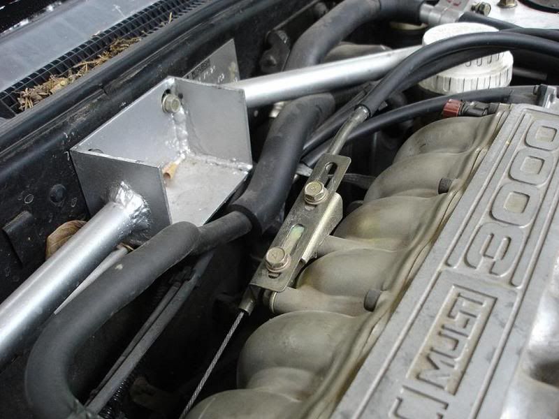

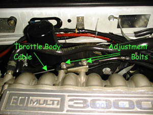

Adjusting the Throttle Cable on a 3000GT (http://www.supercar-engineering.com/rubberducky/3S/Maint/All/ThCaAdj/index.html)
Check the Play in the Throttle Body Cable
http://www.supercar-engineering.com/rubberducky/3S/Maint/All/ThCaAdj/tn/01-TBCable.jpg
This is the cable that goes from your cruise control box to the throttle body. The spec for free play in this cable is 1-2mm for manual transmission cars and 3-5mm for automatic transmission cars. It can be adjusted by loosening the two nuts in the picture and sliding the bracket away from the throttle body to tighten the cable. Make sure you don't tighten it too much or the throttle plate will never completely close. Often, this is the only adjustment you'll have to make to reduce free play in the accelerator cable.

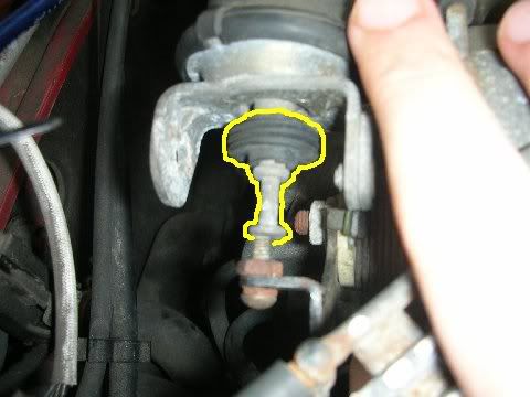

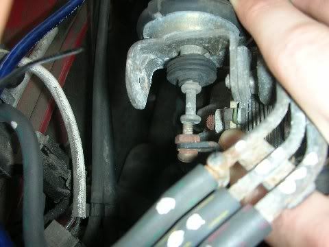

as soon as i let off the gas, the two peices contact, but it doesn't get to compressed/resting position for at least a full second after. again i wish i had a video to show u guys. pic one, is right at contact, and the second is after it comes to rest. hopefully u guys can see what im talking about.
http://i115.photobucket.com/albums/n287/gismojames212212/4-1.jpg
http://i115.photobucket.com/albums/n287/gismojames212212/5.jpg
it doesn't look like much of a difference in these pictures but im thinking it can definetly account for the extra revs before the rpms start falling during shifting. does anyone know what the upper peice even is? i'll be happy to buy a new one and see if that works, i just have no idea what to call it. perhaps there is some owners manual online or part by part diagram online? i know they sell repair manuals in stores for like 40 bucks, i'd like to download one for free but i dont mind looking through one to try and find it.
