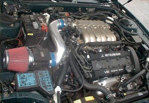

check your MAS. the damn oil change ppl could have unplugged for reasons unbeknownst to humanity when changing/check your air filter. if your MAS is unplugged it will cause idle to fluctuate then die. in the pic below, the MAS is the black square computer located between the air filter and the shiny intake pipe.

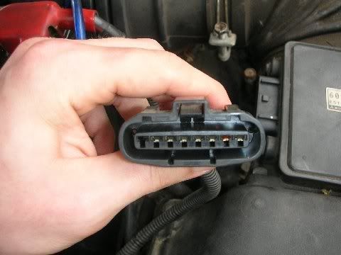

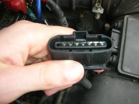

ok got some pics, the second peice from the right is a different color and pushed back. it doesnt look as pushed back in the pics but it def is. i dont have any speaker wire to make individual connections with to see if thats the problem or not. should i look into that? i can def see how it would determine if that was the problem or not.

if it was the mas though wouldnt the rpms be jumping up and down all the time, because even though it doesnt seem to know how fast idle should be its not like the rpms rise and fall continually when idling, they only change from day to day or with engine temperature.

i highly doubt the MAS is the culprit. as you said, if the MAS was faulty, it would do it all the time, rpms jumping up and down.
first, focus on your throttle body, as Igovert500 suggested. take it off, take it apart and see if the butterfly valve operates properly in conjunction with the pulley that the throttle cable is attached to. WD40 is your friend. use plenty of it. some of those bolts look a bit rusty.
