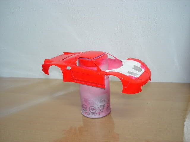

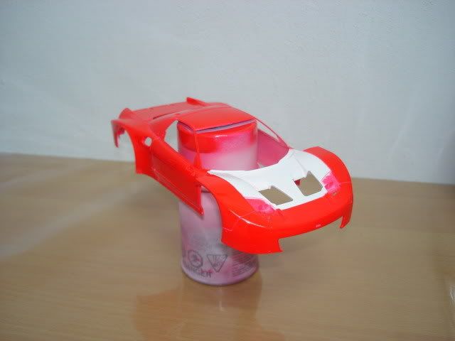

PS: i took a pic using my digi cam but it looked slightly fluorescent in it. However, its solid red when looked at using bare eyes.
Could it be that i've sprayed the paint too thick? Is there anyway i can mix flourescent red out of tamiya acrylic paint?
I didn't use any primer because i'm worried it'll get too thick. so i just sprayed 3 coat of TS36 on it since the body is molded in white. I've noticed that i got a slightly brighter or fluorescent red on the one part that i only sprayed one thin layer coat of TS36. btw, is there any such thing as mixing fluorescent colour out of acrylic paint?
Sheene machine, your bike's fluorescent red is the one i wanted but mine just looked solid red!:banghead:

Looking at the photos it raises more questions to me.
Did you spray any mist coats or just heavy coats?
How much time did you leave between coats?
I suggest you perhaps strip the paint and start again, the red looks very heavy and uneven suggesting you didn't use any mist coats and just layed down some heavy coats.
Primer would also help the paint stay more even as it gives the paint something to bond too as opposed to just the plastic.

Looks to me like the paints coats have pooled , ie the paint has run into spots on the body creating darker shaded areas which you refer to as solid red. Looking at the photos - the red looks to flouresce ok - just the body has darker patches about. You will need to do what Freakray has suggested and strip it all off. Use a white primer, 2 or 3 lights coats should be fine - allow to dry overnight and gently wet sand with a fine grade paper to smooth it out. Then reshoot your TS36, a couple of light coats at first, then slowly build up the coats. The first coats will almost look pink - don't be fooled into applying the coats heavy at this stage - slowly does it! Allow some time between coats - 10 minutes or so - 3 to 4 heavier coats should get the coverage you looking for. Oh - and read the FAQ and How to's - they are very good and designed for newcomers.
exhaust smoke
08-19-2006, 12:33 PM
Looks like you have sprayed too heavily and the paint has built up in areas and dried thick. Probably best to strip off the paint, prime with Tamiya primer and mist the coats of TS36. Primer and the mist spraying will provide a key for the paint. I find that Tamiya aerosols are usually quite thin and run easily at the best of times.

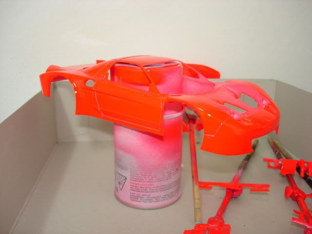

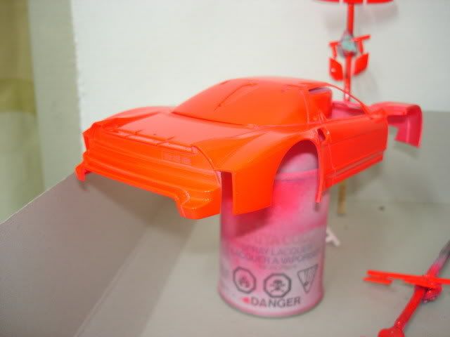

I don't quite get what you mean :) But i've tried like the seniors here told me before, primer then TS36 and i got quite a satisfying result this time :)
http://img.photobucket.com/albums/v518/Eugene_kho/zDSC03080.jpg
http://img.photobucket.com/albums/v518/Eugene_kho/zDSC03075.jpg
http://img.photobucket.com/albums/v518/Eugene_kho/zDSC03086.jpg
I've left it to dry for about a week now for my next TS26 :) Thanks for the info anyway :)

Always always prime before spraying colour... i think those paint pools are due to that u didnt prime the model... i dont see any other way to get those pools unless u spray on a spot for awhile lol... which i doubt u did anyway.. good luck
