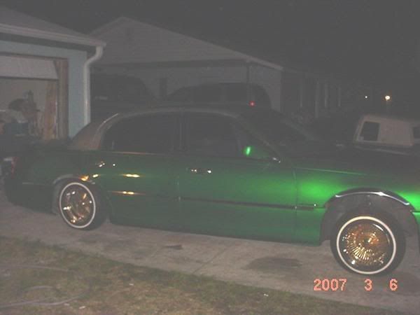

my car rides pretty good droped but i got a few mods done to the frame and put new bump stops on and lowing shockshttp://i26.photobucket.com/albums/c140/str8dirty/l_51a37e0013af4a626cf5089f9085e4ff.jpg

my car rides pretty good droped but i got a few mods done to the frame and put new bump stops on and lowing shocks http://i26.photobucket.com/albums/c140/str8dirty/l_51a37e0013af4a626cf5089f9085e4ff.jpg
Now that's amazing!
Now that's amazing!
candycoatedlinc
09-05-2007, 12:34 PM
Now that's amazing!theres always sum1 hating on sumthen all i was trying to say to the guy is that the car only rides hard cuz the stock shocks bottom out and the lowing shock will smooth the ride for 39 dollors i mean damn
