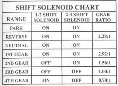

Maybe this will be less confusing. The shift solenoids work together in the form of a matrix or logic gate depending on where the transmission range switch is set. And you can add the 3-4 to the 1-2 shift solenoid for labeling purposes if you'd like. But this should be self explanatory and less confusing on how the solenoids work.
http://i5.photobucket.com/albums/y186/lizzywiz/atsg.jpg

that makes more sense, but now it's more confusing which one is bad. =All the more reason for a rebuild if you need to swap out one of the solenoids.
A good chart to have. I'm just thankful I don't have tranny problems yet.
