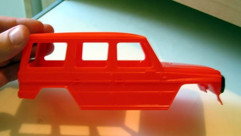

Basically I wanna start with this kit:
http://img.photobucket.com/albums/v215/bigfrit/aloo017.jpg
to make this car...

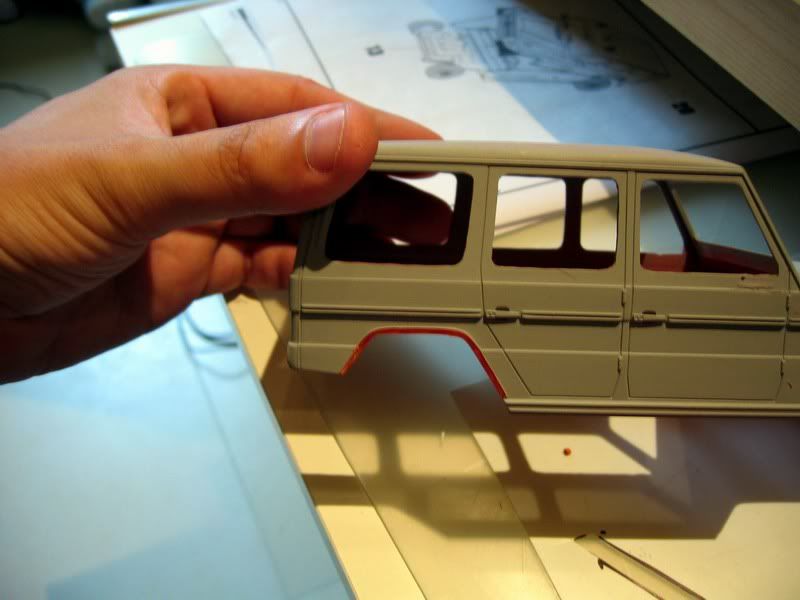

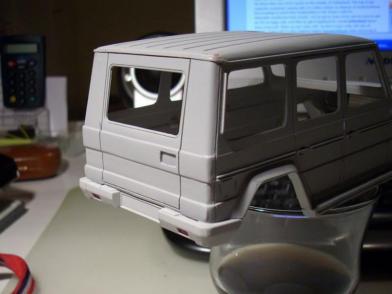

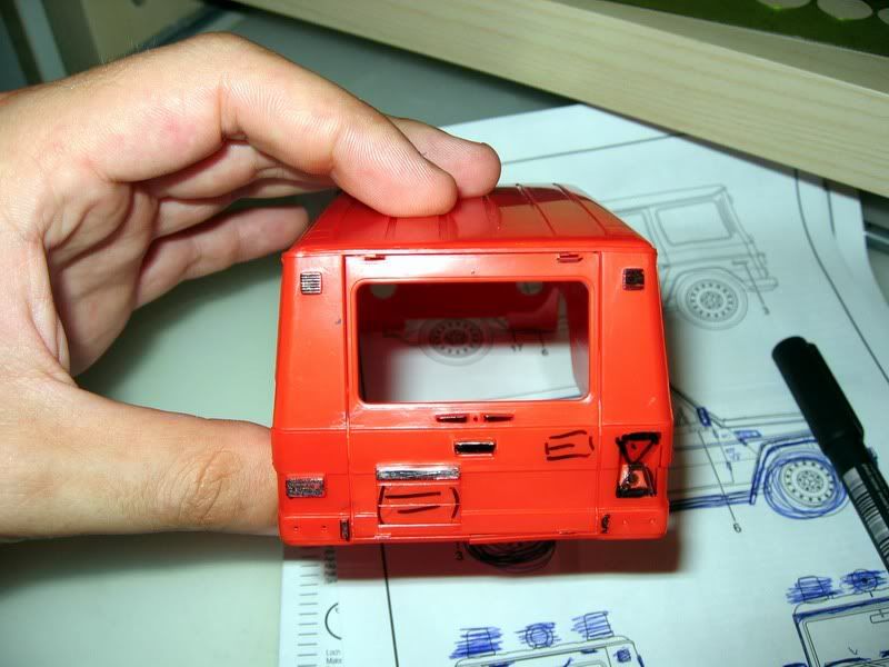

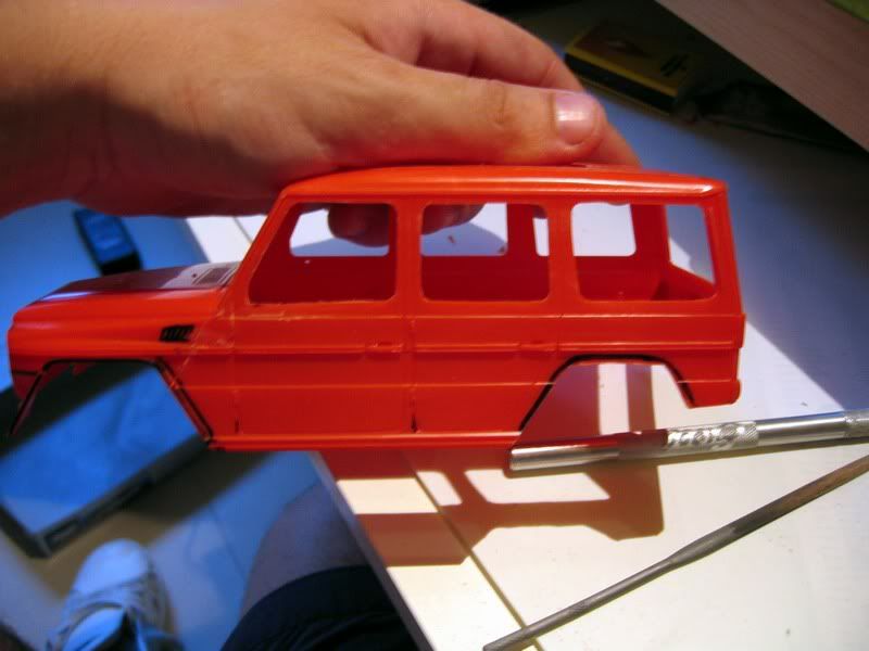

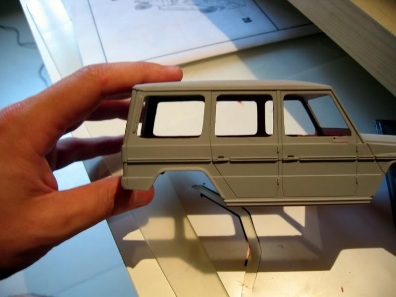

http://img.photobucket.com/albums/v215/bigfrit/aloo001-1.jpg
http://img.photobucket.com/albums/v215/bigfrit/aloo011.jpg
http://img.photobucket.com/albums/v215/bigfrit/aloo012.jpg
http://img.photobucket.com/albums/v215/bigfrit/aloo013.jpg
http://img.photobucket.com/albums/v215/bigfrit/aloo014.jpg
http://img.photobucket.com/albums/v215/bigfrit/aloo024.jpg
http://img.photobucket.com/albums/v215/bigfrit/aloo025.jpg
http://img.photobucket.com/albums/v215/bigfrit/aloo033.jpg
http://img.photobucket.com/albums/v215/bigfrit/aloo046.jpg
http://img.photobucket.com/albums/v215/bigfrit/aloo032.jpg
I m bored with talking, I d rather answer any questions or whatever you might have!

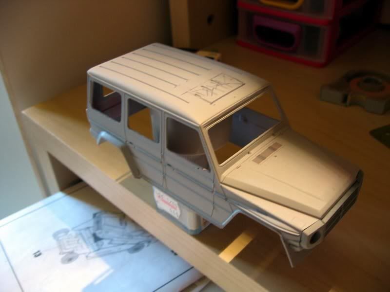

bigfrit
08-15-2006, 08:56 PM
's Ok, mister Fubaz, I got the references covered, thanks for the offer, tho!
Here's a mini-in-between update, because I know somebody who loves fuzzy pictures.
http://img.photobucket.com/albums/v215/bigfrit/AMG.jpg

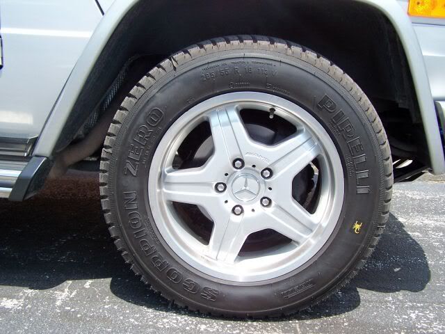

BTW, I m still looking for some rim as a base to make this one
http://img.photobucket.com/albums/v215/bigfrit/8e_4.jpg

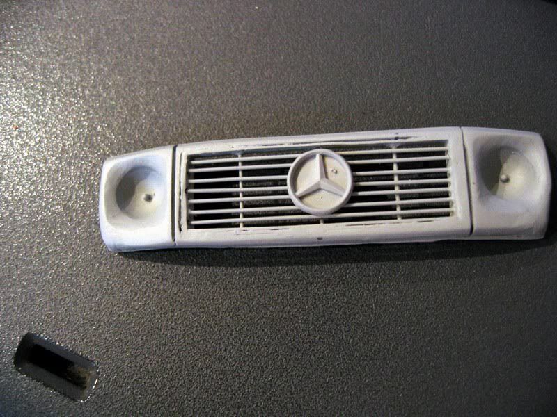

Oh yeah, btw, I redid the grille stacking styrene instead of using brass tubing, it looks more realistic...
Otherwise, the roof has been finished, i got a roof of a mercedes S600 to go on it.
Otherwise I did smoothing overall and am working full on on the front.
Oli

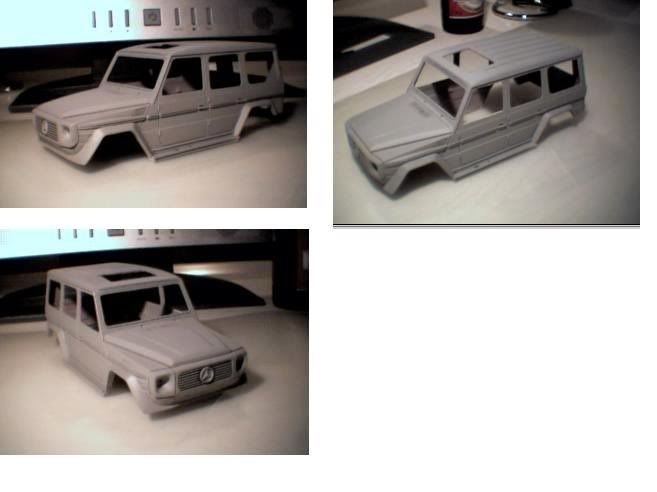

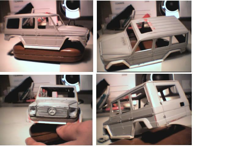

bigfrit
08-18-2006, 10:59 AM
http://img.photobucket.com/albums/v215/bigfrit/2.jpg
I m sorry, I wasn't able to take more blurry pictures :)
Oli
Oli

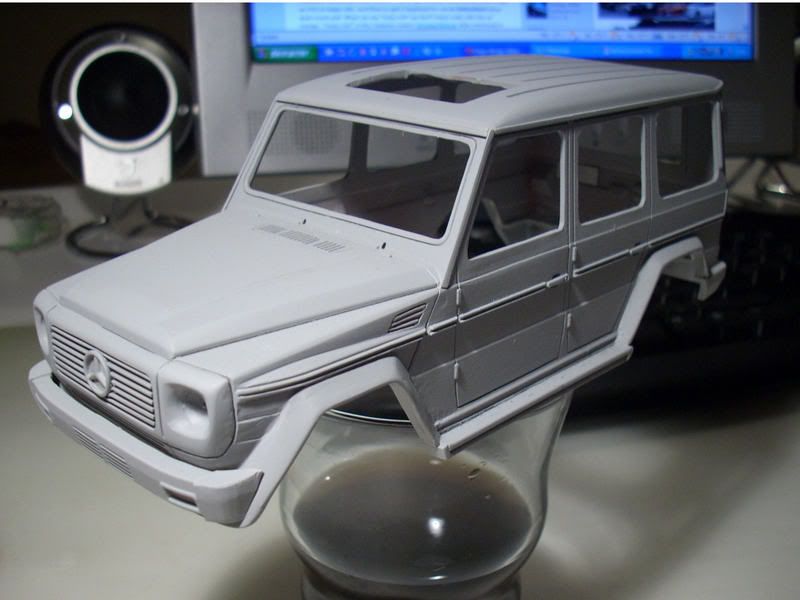

bigfrit
08-20-2006, 07:03 PM

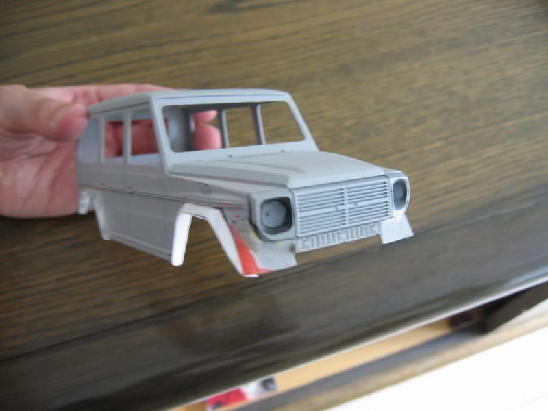

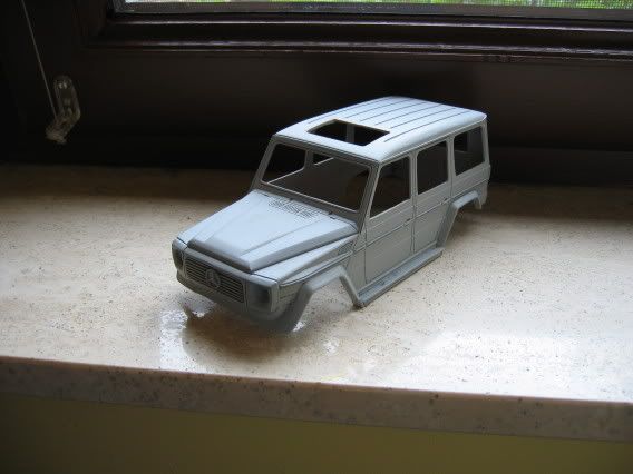

Sweet, I finally got the digicam, so I took some swift shots of how it is now. I did some more smoothing overall and got the roof opening done. Also, the rear and the sides are very close to being finally done.
I just need to concentrate now on making the front part, rear part with the tyre cover and the bumpers.
I ll keep you updated!
http://img.photobucket.com/albums/v215/bigfrit/IMG_0063.jpg
http://img.photobucket.com/albums/v215/bigfrit/IMG_0061.jpg
http://img.photobucket.com/albums/v215/bigfrit/IMG_0062.jpg
Oli

Here is a little update for you all!
I am currently working on the front bumper, which is quite different from the stock one. I have used the parts from the original kit as a base to changeing things.
I left openings for the aeration parts and for the lights, which will be added. Also, I made a spare-tyrecover, but I am actually hoping to give you pictures of the truck in primer tomorrow. for now, bye!
http://img.photobucket.com/albums/v215/bigfrit/makingof001.jpg
here i cut off the little pieces on the sides, to add them later, as they have some stepping to it.
http://img.photobucket.com/albums/v215/bigfrit/makingof004.jpg
widened front bumper, with piece that holds the stuff on it on a right angle.
http://img.photobucket.com/albums/v215/bigfrit/makingof003.jpg
unsanded outside of the bumper
http://img.photobucket.com/albums/v215/bigfrit/makingof005.jpg
ugly as hell bumper testfit.
