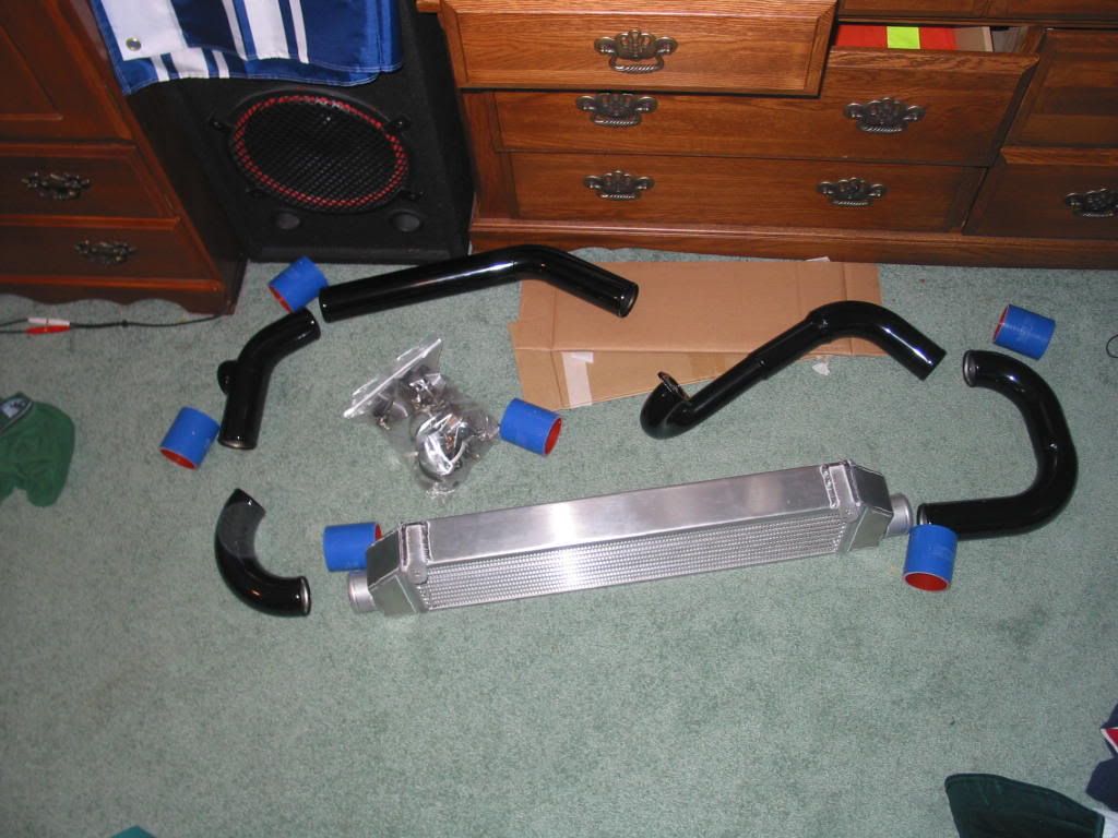

http://i83.photobucket.com/albums/j294/steviekallday/Picture002.jpg
http://i83.photobucket.com/albums/j294/steviekallday/Picture001-1.jpg

blk_srt
08-16-2006, 06:09 PM
That is kind of a small core IMO
steviek
08-16-2006, 06:33 PM
I don't gotta cut the bumper support, or any of the bumper. Thats the biggest you can get without doing that. Its good to 450 hp well above my turbo's capabilities. PLus its a fuck of alot bigger than the stocker@!
