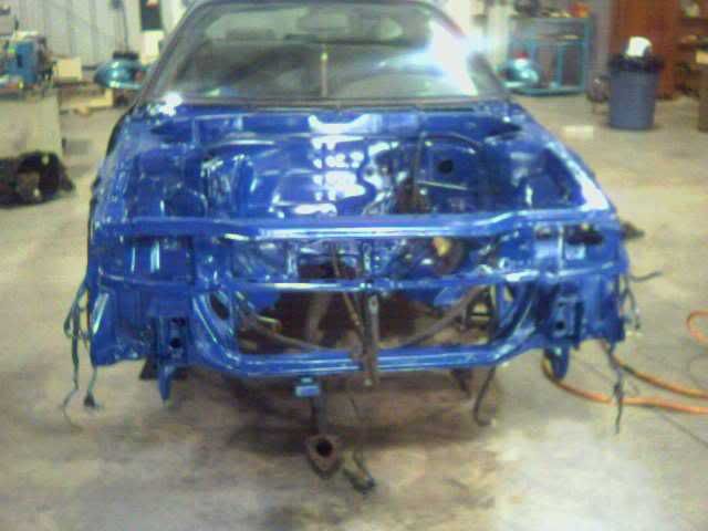

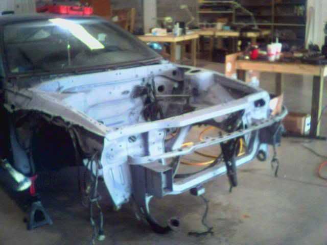

Tonight was a good night I got the entire bay painted Ironic enough I painted it Ford Blue, lol I hate Ford. No offense to you ford Lovers. yeah i will most definatly have some numbers for you guys, i'm not 100% positive on any numbers yet, I'm not going to promise 300 or 400 horse power, I've simply put together what I feel from my research is a good and reliable set up for this engine, but once I get it tuned I will most definately have it dynoed, and I will definately post my results. i will also post pics as I go along, I hope to have the engine up and running in around 2 months.
P.S. blakscorpion21 thanks for the posting pics info i'll try to get those up asap

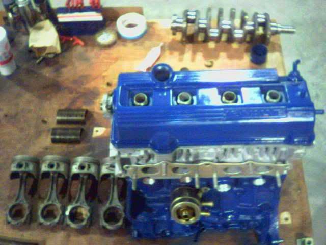

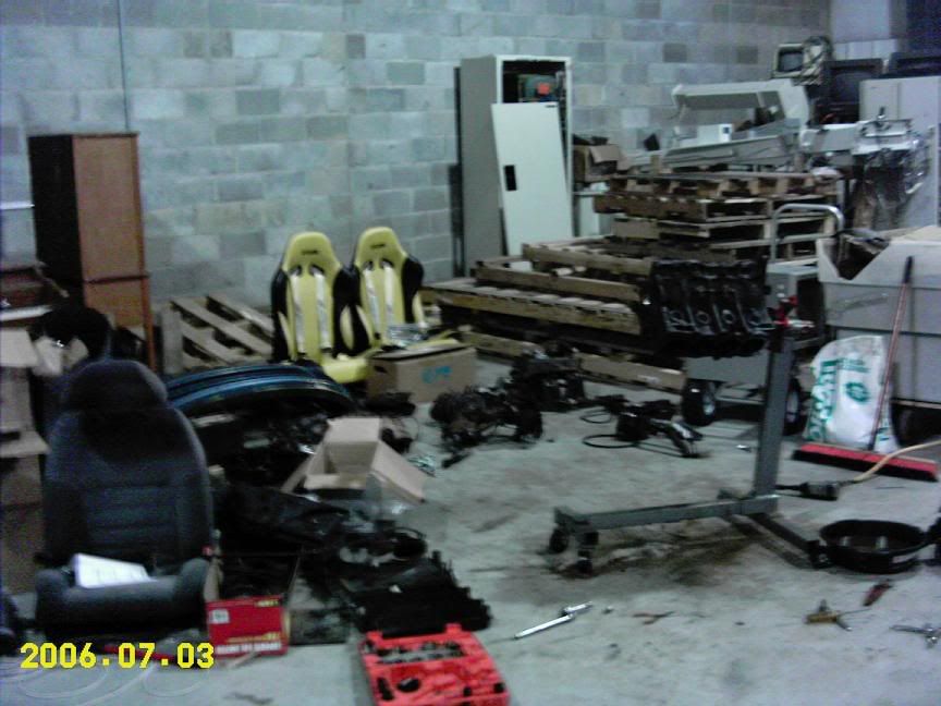

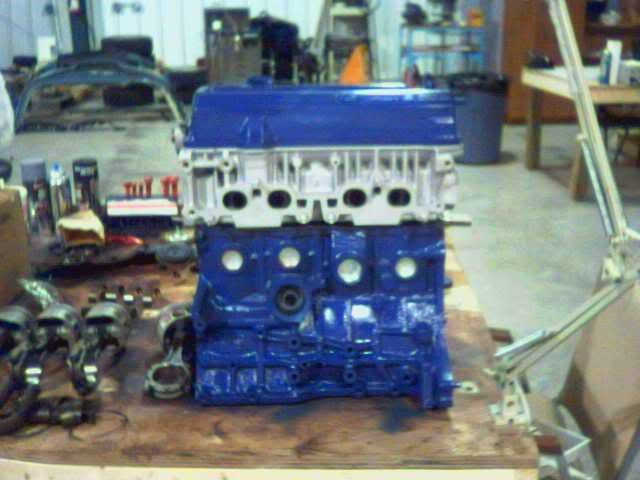

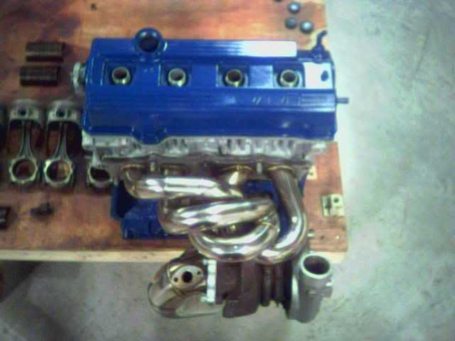

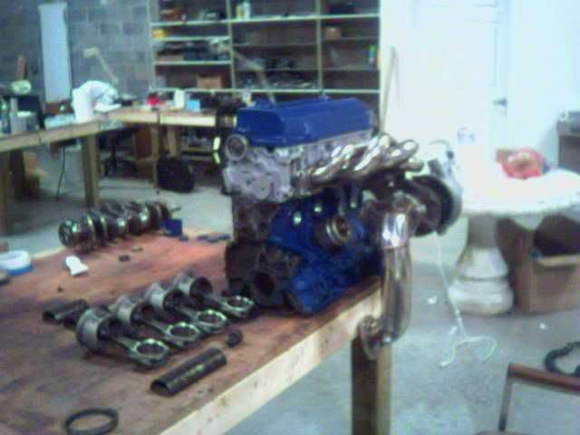

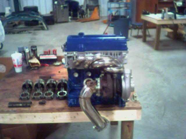

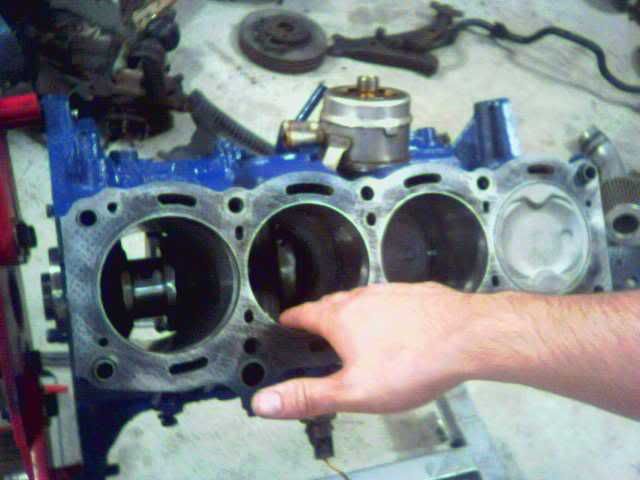

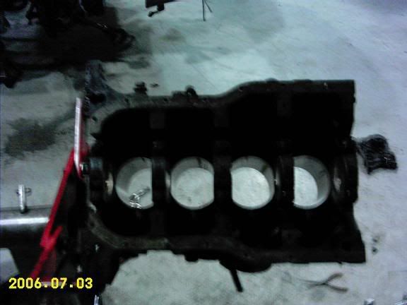

Alright well here are the pics I think I finally figured out how to get these on here, now just so you know I didn't actually forget to put the pistons and the crank back in the engine lol. I simply wanted to see what the block and teh head and the valve cover looked like all put together with the chrome manifold and the turbo on, its not actually bolted all together so when you see the pistons next to the block with the crank behind it, don't freak out I didn't forget anything lol. But here is what I have up til tonight, I still have a long ways to go but its starting to progress nicely.
http://i103.photobucket.com/albums/m121/celica5071/IMAG0033.jpg
http://i103.photobucket.com/albums/m121/celica5071/IMAG0032.jpg
http://i103.photobucket.com/albums/m121/celica5071/IMAG0082.jpg
http://i103.photobucket.com/albums/m121/celica5071/IMAG0085.jpg
http://i103.photobucket.com/albums/m121/celica5071/IMAG0090.jpghttp://i103.photobucket.com/albums/m121/celica5071/Image0049.jpg
http://i103.photobucket.com/albums/m121/celica5071/IMAG0096.jpg
http://i103.photobucket.com/albums/m121/celica5071/IMAG0099.jpg
http://i103.photobucket.com/albums/m121/celica5071/IMAG0100.jpg
http://i103.photobucket.com/albums/m121/celica5071/blockmachinedandpainted3.jpg
http://i103.photobucket.com/albums/m121/celica5071/blockmachinedandpainted2.jpg
http://i103.photobucket.com/albums/m121/celica5071/Image049.jpg
http://i103.photobucket.com/albums/m121/celica5071/Image058.jpg
http://i103.photobucket.com/albums/m121/celica5071/Image059.jpg
http://i103.photobucket.com/albums/m121/celica5071/Image060.jpg
http://i103.photobucket.com/albums/m121/celica5071/Image0058.jpg
http://i103.photobucket.com/albums/m121/celica5071/Image0059.jpg
http://i103.photobucket.com/albums/m121/celica5071/Image0060.jpg

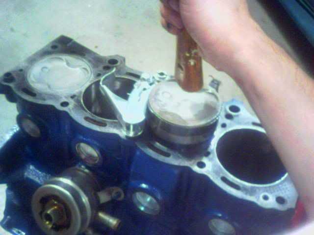

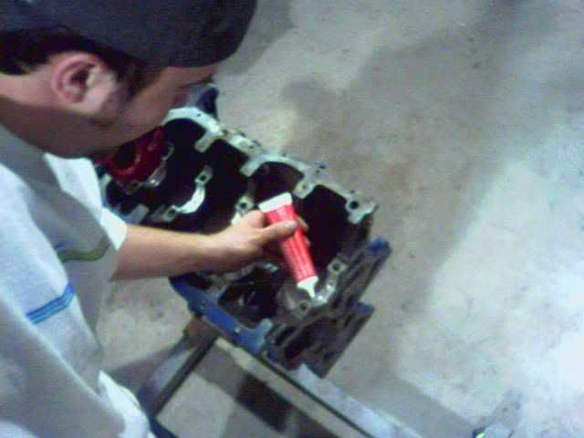

well here are pics of tonight, I got the caps off the pistons, and installed them, they went in very smooth.
{Lubing the main bearings before I drop the crank in}

{Pistons ever so lightly tapped in}
http://i103.photobucket.com/albums/m121/celica5071/pistoninstallations.jpg\

i give your maifold 1 month before it breaks, the downpipe 3 months if not properly secured, if you can find a way to support it on the stock bracket, it may live
good build, but never go with XS crap, it WILL break in the long run, ive bought 3 things from them to test out and theyve all broken
