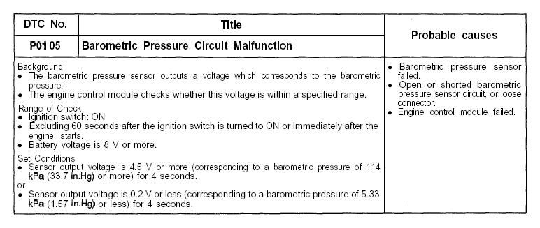

here is some more info i found on bps code 25 (NOTE: its says DTC P0105 in the pic b/c that's the code for 96-99 models. however, since its the same sensor, i'm sure the description/diagnosis is the same.)
