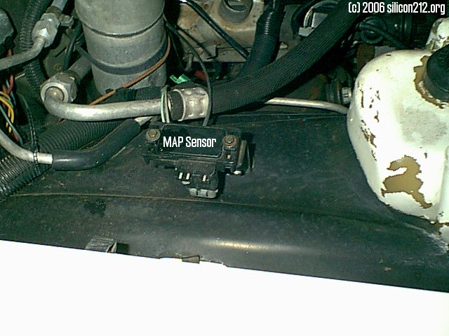

The MAP sensor is that rectangular shaped thing on the passenger fender with three wires and a vacuum line on it. If the vacuum line is broken, you will get this code, so make sure that vacuum line is attached.

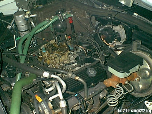

http://www.silicon212.org/9c1/images/engine.jpg
This is the engine bay in my car, from the driver's side at the front. Yours will be a little different, due to it being the bathtub Caprice and mine being the boxy Caprice. Mine is also carbureted, yours is TBI. However, the details we are wanting to see will be the same between the cars.

http://www.silicon212.org/9c1/images/msdetail.jpg
This is the location of the MAP sensor, from the same location as the other two pictures.
http://www.silicon212.org/9c1/images/mscloseup.jpg
This is a closeup of the MAP sensor.

KK, think I know where the ops is then.. will check that tomorrow and see if I can check the MAP (which is coding now - I do know where it is)...

I can't for the life of me find the oil pressure switch - can't get anyone mechanically inlcined to come help..
The pix are great! But, mine doesn't look exactly like that, nor do I see anything else that does for the o.p. switch :(

The CODE 33 cleared - I forgot to reattach the vacuum line to the MAP.
Back to it still won't crank, unless primed with gas in the TB. :(
I do see where the wire goes from the distributor to the coil.. and it has 2 relays or w.e. on top. But I do not see anything to the right hand side (driver's) of the distributor.
Does anyone else have a picture of a 92 caprice oil pressure switch location or a link to where one would be found... I have looked for hours on hours to no avail ... and the book I got from Autozone (Haynes) doesn't have it labeled either...
Thanks for hanging in there with me!!!!!!!!!!
Thanks for pictures!!!
I promise I'm trying...
