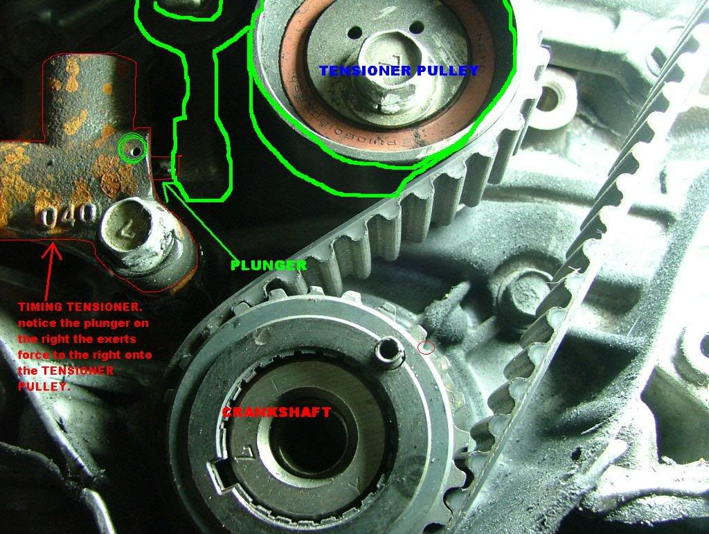

Linebckr49
07-30-2006, 01:37 AM
This timing issue is a little confusing. If it has jumped a tooth how would you adjust it? I would assume that basically what you are doing is installing a timing belt and to do it right you would first make sure that everything is lined up before you put the belt back on. I don't see how adjusting the CAS would help with the timing of the engine if the timing belt is installed without first making sure the timing mark on the sprocket is lined up with the other one.
you're exactly right. your intuition and logic is wonderful. because, for example, say we used the strobe light method and then found timing was off. well then we would have to do the alignment method to verify timing was off, then correct timing by method 2.
so to answer your question about how to correct the timing, you simply remove the belt, align the marks (camshaft sprockets, crankshaft), and re-install belt.
however simple it may sound, its a bit technical because we have a hydraulic automatic timing tensioner. this part is the crux of our engine. so we loosen the tensioner PULLEY, which will loosen tension on the belt. belt can be removed, timing marks aligned, belt re-installed, and then the hard part is re-installing the timing tensioner.
a picture can help me explain this better. on the right side of the timing tensioner i've circled a hole in green. the plunger on the timing tensioner must be compressed in a vice (i've used a c-clamp to apply slight pressure before, but i wouldn't do it again, nor would i recommend it). once the plunger is compressed far enough, a metal (tough, sturdy metal) pin, aka the grenade pin, can be inserted through the circled hole, which goes through the plunger, and out through the hole on the opposite side of the tensioner. this pin will secure the tensioner so it can be re-installed.
http://i57.photobucket.com/albums/g236/Linebckr49/3000GT/tensionerpulleycranktimingmarkNOTED.jpg
HERE IS THE ORIGINAL PIC, FOR SAKE OF CLARITY.
http://www.electronicsam.com/images/morecar/DSCF4632.jpeg
when re-installing the timing tensioner, you must put the right amount of force on the tensioner pulley, which in-turn exerts force on the timing tensioner. you know you've put the RIGHT amount of force on the timing tensioner (via tensioner pulley) when you can spin/twist the pin freely inside the hole in the timing tensioner. you should also be able to move it in/out freely (but don't remove it entirely, just move it back and forth). now you've set the proper torque on the tensioner pulley, tighten the bolt on the pulley so it will stay in place. then test to see if the pin moves freely. if yes, you've done it right and can remove the pin! if no, then loosen the pulley bolt, reset the force on the tensioner via the pulley.
this picture can help explain. it was taken from the user manual.
http://i57.photobucket.com/albums/g236/Linebckr49/3000GT/timingtension.jpg

Again,Thanks for the info and pictures! My first step today is to get the wheel off and check the belt and sprockets and stuff. Like I said I want to learn something here. John
