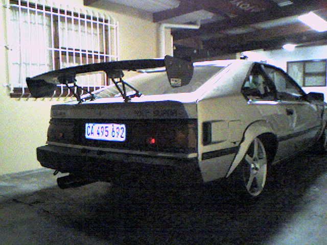

our celica same style of this supra....:
http://i68.photobucket.com/albums/i1/WORX_3SGE/Photo-0008.jpg

yea you will need the Altezza RWD B-housing (super rare) or you will need to find the bellhousing from another older RWD 5S-FE(same engine family) i iwll try to dig it up the second way is much easier. the celica you haev is either an RA64(carb) or RA65(FI) these are not direct bolt in setups as you will haev to do A LOT of custom work
