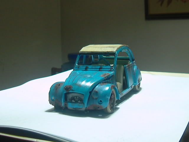

What I used to do is not by using lighter because it did not have constant heating. Too near and it will melt and too far the plastic just won't bend. What I use is the lighter which uses filament rather than the traditional types. Candle fire is also a no-no.
I usually will heat it bit by bit and making sure that the plastic will be soft and not melt. Then I will push it using erasers to make the dents. Here's an example of the dent that I made using the mentioned method on the front left fender and the front bonnet.
http://i6.photobucket.com/albums/y223/druid_99/Old%20Faithfull/DSCF0208.jpg
