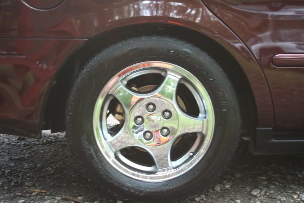

There is a ton of bad information in this thread.
The rear disc option was ended in 1999 except for the station wagons.
The station wagon hardware will not fit.
You need the set up off an ABS Taurus and any of them will fit.
I spent an hour and half pulling the parts in a salvage.
And maybe an hour a side pulling the drums and all its related hardware and hoses and rerouting cables and installinng all the new hardware when I did the install.
You need the pie tins, backing plate ,hoses,hub/bearing,rotors,brackets,calipers,pads
Ebrake cables and prefferably the abs sensors.
This can all be had out of a Donor car for under a hundred dollars.
A lot of people have done this conversion on the 2000 and up including me and it was well worth the effort.
I did notice an increase in stopping power and the abs system works fine.
You dont have to change any computers ,modules or anything other than adding the correct ABS Sensors.
http://i34.photobucket.com/albums/d132/mwt60/IMG_4103.jpg

This is the internet and getting in a pissing contest will prove nothing.
Ford did not offer rear disc brakes on a sedan for the model year 2000 or newer.
It was offered on the Station Wagon. The Station Wagon rear brakes will not fit a sedan and never have since the inception of the Taurus.
in theory you can use any Generation Taurus sedan setup on the 2000 and newer but the GenIII (96-99) with ABS is the most straight forward.
The picture I posted is a 2000 SES 24V DOHC. I converted it myself from Drums to Disc. I also put the 2001 larger front disc setup on the front of it.
I also have a 2000 SEL 24V DOHC which is the top of the line offered that year and it has drum rear brakes also.
I spend way too much time on the Taurus and SHO forums and there has never been one instance of a person claiming that they have a 2000 or newer Taurus with Factory Rear Disc brakes.
You will not find any listing for rear disc brake parts for a 2000 or newer sedan from Ford or any after markert supply house.
Like I said, I have no intention of arguing with you, I am just stating facts.
Mike
:smokin:

I'd like to do this conversion on my 2004 taurus ses duratec as well. Not sure about other years, but I know that the 2004 sel sedan has rear disc brakes (this IS the sedan, NOT the wagon)
mwt878991
07-26-2006, 09:04 PM
Can you get pics of it?
