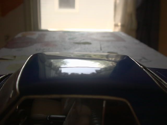

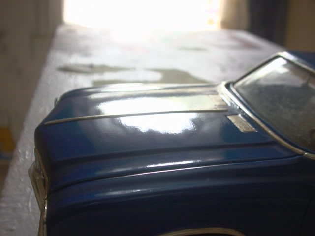

I just painted with Shimrins kandy paint.. and had to wetsand and this is how it turned out...
Hood picture is before I wetsanded..
Roof is after. .I know you all will see the differenced
http://img.photobucket.com/albums/v43/scarface199/1970%20Cutlass%20SX/th_DSC00134.jpg (http://img.photobucket.com/albums/v43/scarface199/1970%20Cutlass%20SX/DSC00134.jpg)
http://img.photobucket.com/albums/v43/scarface199/1970%20Cutlass%20SX/th_DSC00133.jpg (http://img.photobucket.com/albums/v43/scarface199/1970%20Cutlass%20SX/DSC00133.jpg)

very noticable difference!
