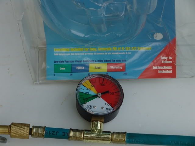

This is the hose and gauge I use. It came from Advance. According to the gauge, about 45 lbs. is the upper limit.

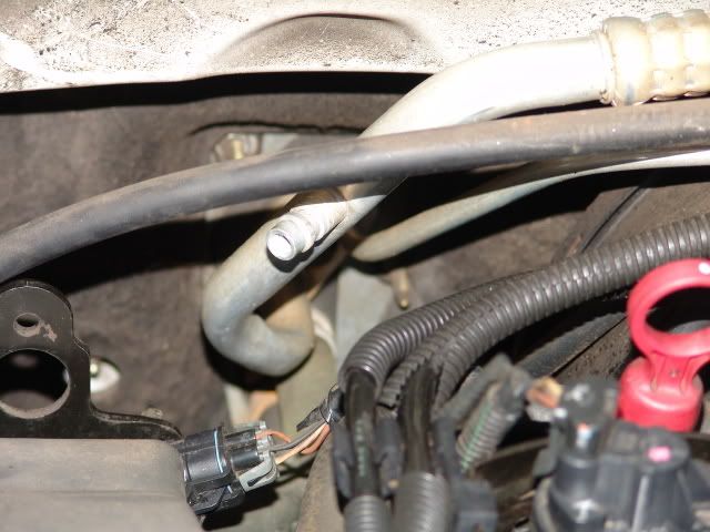

The low pressure port is the smaller of the two ports, located up top to the left of the trans. fluid dipstick, dust cover removed for clarity. The high pressure port is under the brake master cylinder and should not be used.

Well thank you all very much once again and for the pics too, now that you mention it i belive i do recall the compressor clutch making clicking sounds even before the air went completely warm. ill recharge it and if it gets warm again then it must be a leak somewhere. thanks again! :)

ok so me and a friend put in the freon today and all went well, it took the whole can of it to get the pressure right up to about 45 where it should be, the ac is cold once again but i saw the can says it has some kind of leak stopper? how effective is that? also the air IS cold on both sides but i can feel KIND OF somewhat of a difference on the drivers and passenger sides, should i put a little more in or would i risk doing any damage or injury exceeding the pressure of 45? or would adding in more not do anything at all in making it colder? i just want to get both sides even, but i think its pretty close to even, just wanted to know if thees anyhting else i should do to get it perfect. if not im happy with the way it is anyway. as long as it stays cold

I'd doubt that the leak stopper will have much effect, at least it hasn't for me. You will probably have to add a can every year unless your leak is significant at which point you would want to have it repaired professionally. I wouldn't add any more if it is up to 45.
