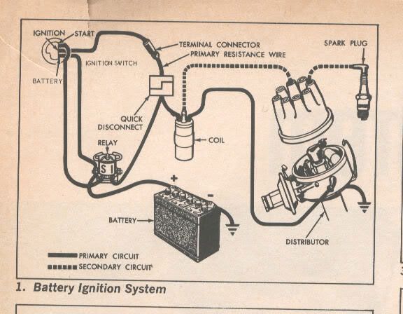

Here you go - here's some general stuff that might be of use:
Also, I am sure I remember there being a pretty good thread here on AF about wiring and wire sizes etc. A SEARCH should turn it up for you.
This is a schematic I found on the web:
http://i6.photobucket.com/albums/y247/klutz100/wiring-diagram.jpg
