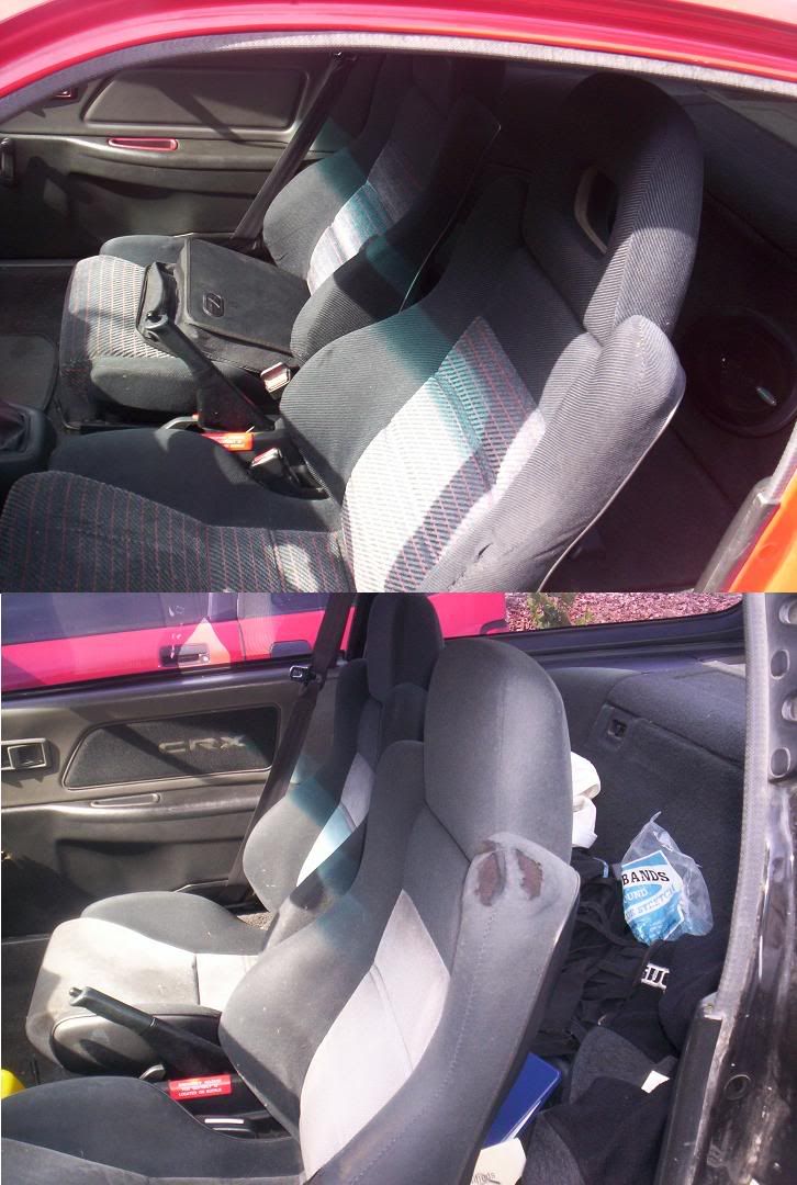

UMMM..not much to tell guys it is a straight swap over.. 90 SI Seats >>>> 89 DX..I don't see what all the seat pan swaping garbage on Honda-Tech was about...same seat pans..same mounting points..took me like a hour and a half to do. I don't see how people were saying it was off "2 inches" It looks like it at first but you gotta adjust the rails so the 4 holes line up with the holes on the floor... well that's about it :)

Not on mine dude...the rail isnt only not the right length..but it has a gap between the seat pan and rail on the front right (when siting in it) mounting hole..its like ann inch at least..
DirtyD777
07-09-2006, 05:13 AM
yeah..well i dunno maybe yours is special and different. But what I did is 1st bolt in one of the holes (cause only one lined up at first) then just grab the little lever under the seat and move the seat back and forth til they line up with the holes...i'll take more pics if u don't beleive me..the four holes in the floor are in the exact same spots in my 89 dx and her 90 si..I ever put my dx seats in her car til her "racing seats" get here..lol

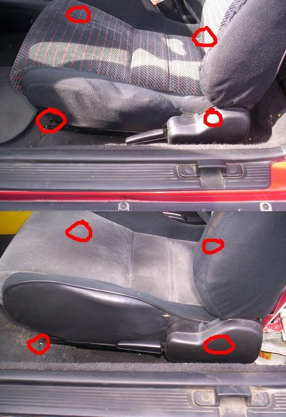

hmm okay here's afew pics i just took of my dx seats in her si and her si seats in mine..I know they don't show much.
http://i82.photobucket.com/albums/j260/RPG_Freak777/seatsswapped.jpg
http://i82.photobucket.com/albums/j260/RPG_Freak777/boltareas.jpg
and I feel like I'm kicking a dead horse but I'm telling you..you dont' gotta swap the pans..just bolt one in and move the rails til they line up. Messure your rails with a tape measurer they must be the same lengths.. I don't see how your's could be different then mine.

Dude..the floor pattern was the same..I pulled the seat and even tried to bolt the rails to it ut of the car, they just would not bolt to the seat, whatsoever. and I couldnt just slide em back and forth, the upper part of the rail (seat side) is one piece.
