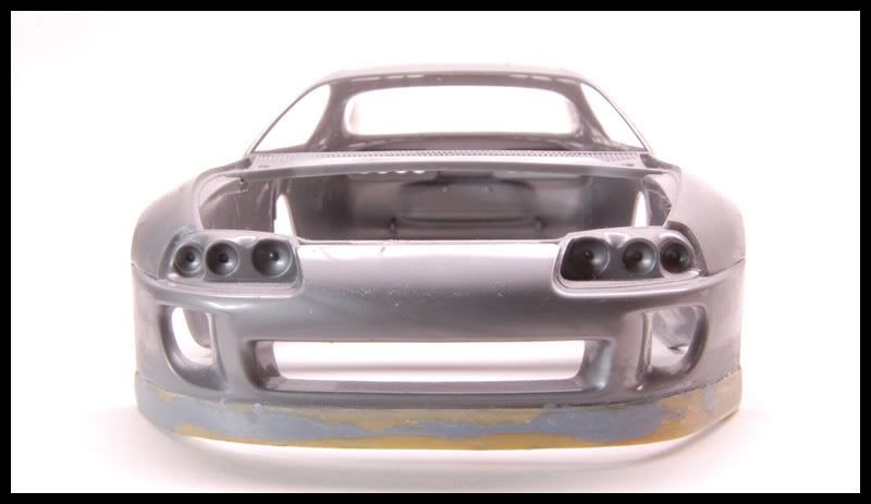

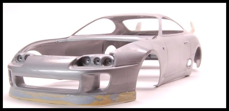

Thursday. Applied some Tamiya Epoxy Putty over a styrene frame which is under the lip.
http://img224.imageshack.us/img224/9505/dsc025218cu.jpg
http://img221.imageshack.us/img221/5964/dsc025205iu.jpg
http://img525.imageshack.us/img525/4271/dsc025246rt.jpg
Friday. Sanded and filed some of the putty down.
http://img112.imageshack.us/img112/7383/dsc025349nh.jpg
http://img107.imageshack.us/img107/5525/dsc025334mi.jpg
http://img107.imageshack.us/img107/7947/dsc025328em.jpg
http://img97.imageshack.us/img97/6145/dsc025310nr.jpg
Today. Put some Tamiya basic putty over the lip to fill up some little holes, etc. Can you guys guess what the car in the background is? ;)

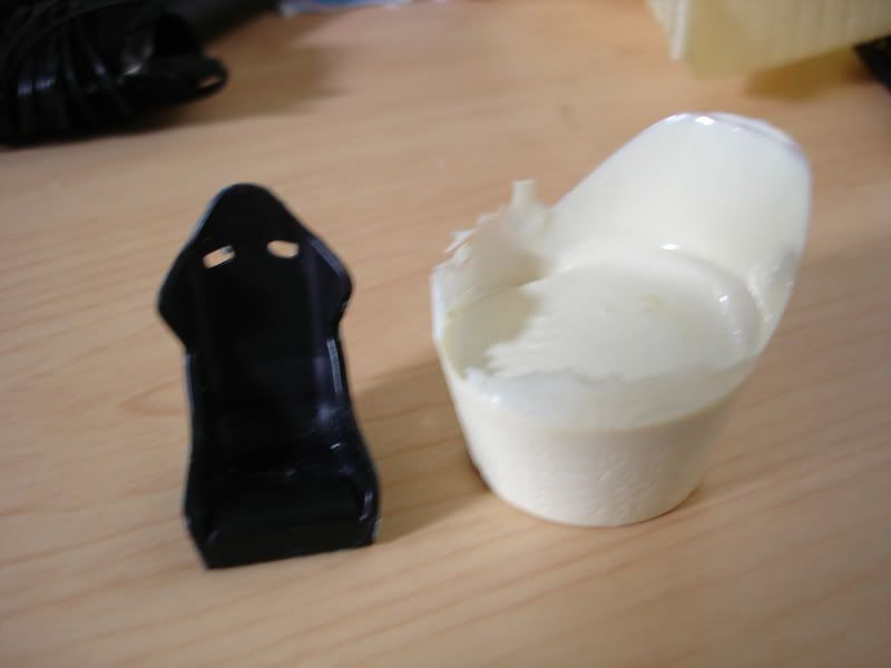

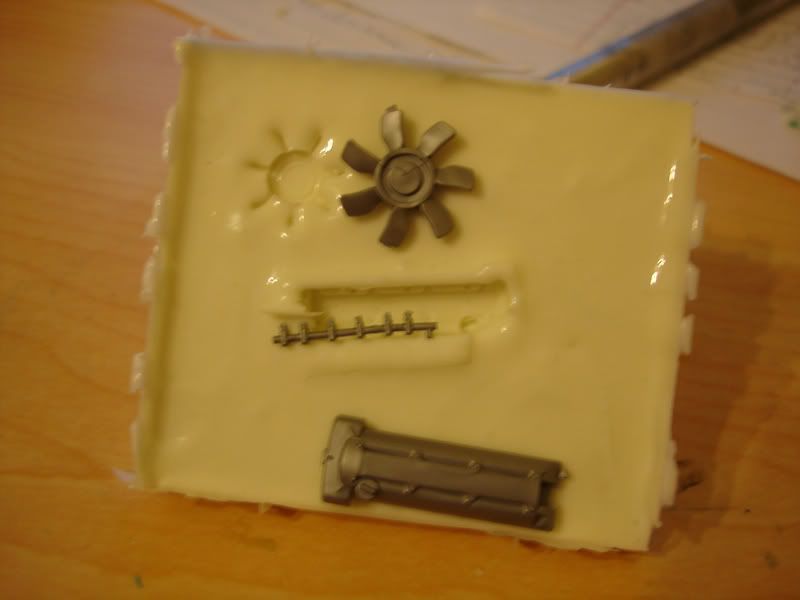

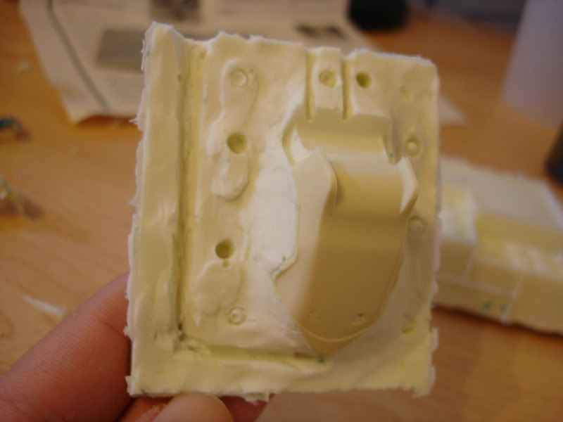

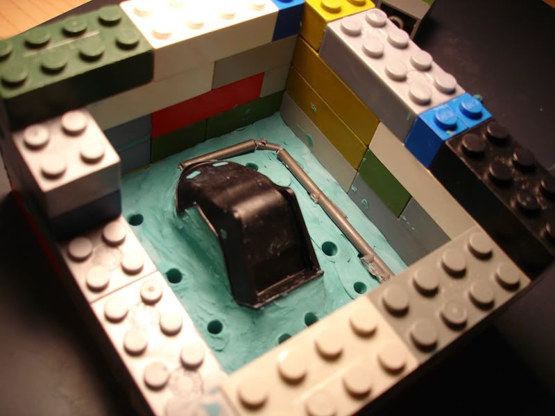

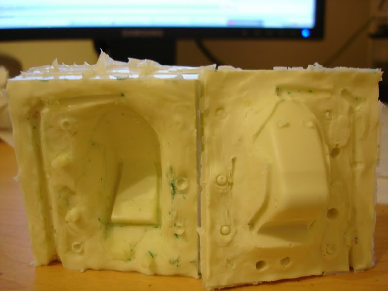

So I tried to make some molds for some seats, the valve cover and radiator fan.
http://i50.photobucket.com/albums/f348/D_LaMz/DSC02759.jpg
http://i50.photobucket.com/albums/f348/D_LaMz/DSC02761.jpg
http://i50.photobucket.com/albums/f348/D_LaMz/DSC02762.jpg
^^^ damn the fuel rail is broken! :(
http://i50.photobucket.com/albums/f348/D_LaMz/DSC02764.jpg
http://i50.photobucket.com/albums/f348/D_LaMz/DSC02765.jpg
http://i50.photobucket.com/albums/f348/D_LaMz/DSC02766.jpg

D_LaMz
12-19-2006, 09:23 PM
mike@af
12-19-2006, 09:29 PM
Thats completely normal. I have a few gallons of that stuff sitting in my basement and it seperates after a few minutes of sitting. Just shake it up really well before measuring it out. It usually mixes pretty quickly.

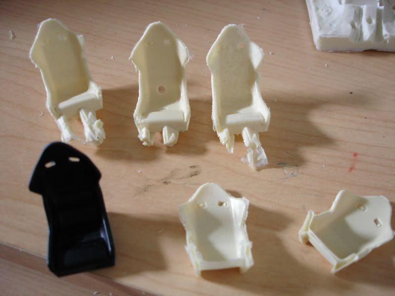

My first casting job... :D
http://i50.photobucket.com/albums/f348/D_LaMz/DSC02770.jpg
http://i50.photobucket.com/albums/f348/D_LaMz/DSC02771.jpg
^^^ I poured the resin in the big main pipe, but it only got to half of the seat. Now I pour through the 2 middle pipes.
http://i50.photobucket.com/albums/f348/D_LaMz/DSC02777.jpg

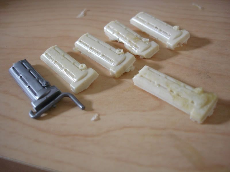

^^^ batch of valve covers the need to be cleaned and un-flashed.
http://i50.photobucket.com/albums/f348/D_LaMz/DSC02778.jpg
^^^2 "half seats" from puring into the single large pipe before I learned to work with gravity. 3 good seats with 1 that I need to fill with putty.
http://i50.photobucket.com/albums/f348/D_LaMz/DSC02780.jpg

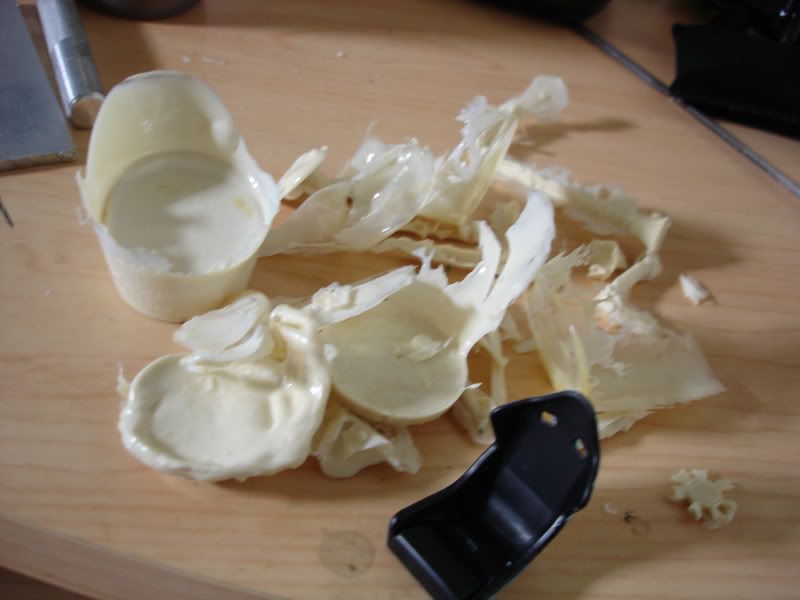

^^^ my first batch of resin. :banghead: Turns out if you put a lot in the cup, it will harden in seconds. That could have been 3 seats and 3 valve covers! :(
http://i50.photobucket.com/albums/f348/D_LaMz/DSC02781.jpg
^^^ left over resin that will go into the trash

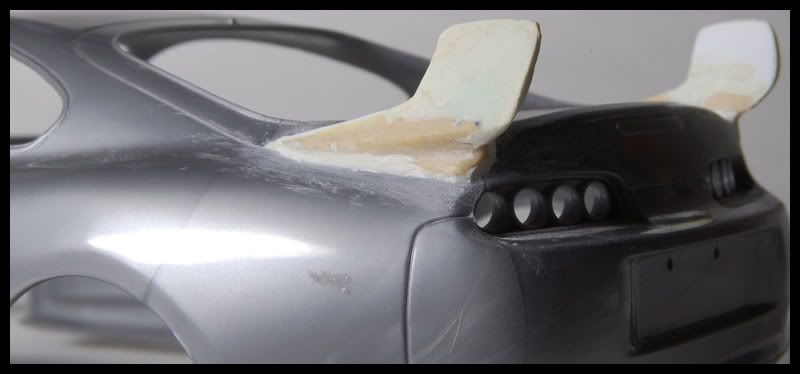

Closer to finishing the RMM Wing. :D I take to long.:lol:
http://i50.photobucket.com/albums/f348/D_LaMz/DSC_0167.jpg
http://i50.photobucket.com/albums/f348/D_LaMz/DSC_0166.jpg
http://i50.photobucket.com/albums/f348/D_LaMz/DSC_0165.jpg
http://i50.photobucket.com/albums/f348/D_LaMz/DSC_0161.jpg
http://i50.photobucket.com/albums/f348/D_LaMz/DSC_0149.jpg
