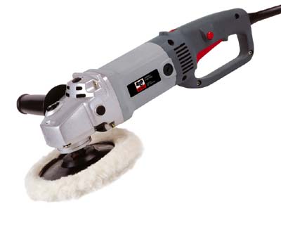

320 is a "finishing" grade if we talk about automotive paints and clear top coats, as later you're going to use something like this:
http://www.navalchicolino.com/images/WK400590.jpg
For models, 320 is very rough. 1500 or 2000 should be your last stage before polishing, unless you use micromesh.
