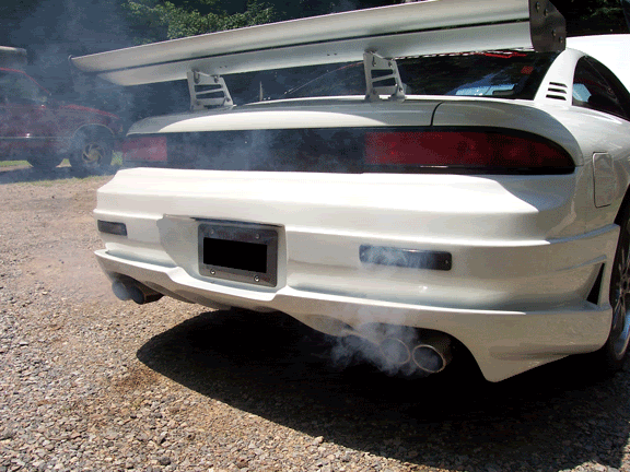

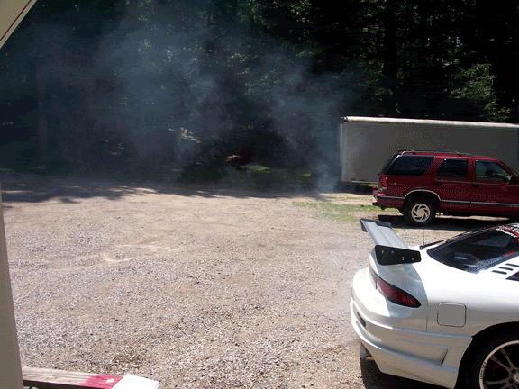

ok so this afternoon i auto started my car. went out in my garage an messed around with a few things. my car was outside. but it sounded like a helicopter with the rumbling sound of the exhaust. i said thats strange maybe theres just a helicopter nearby. so i went to open the garage door an could smell gas. went to go look at my car an white smoke was pouring out of the exhaust. so i ran over an cut it off. after it was cut off the smoke was still pouring out for a good 15 seconds. i knew it was just a matter of time before something went wrong. my car has been spitting out black carbon for the past six months. i always thought it was jus runnin rich or somethin. so i first thought it was the head gasket. checked fluids an the coolant hasnt dropped any. an plus it would smell like coolant instead of gas. also my oil pressure is good. even tho it burns enough that i have to put 1/4 of a quart in between oil changes. so what do u guys think this is? maybe the engine block gasket or something?

white smoke is generally coolant. I'd check your oil for bubbles, and you coolant for yellow crap.
Excess fuel is black and oil is blue.
But the other things don't really point towards a head gasket leak...I dunno. So all your fluids are normal?

coolant level is near the full mark. oil im assuming is good because i just had an oil change last week. but its a very strong gas smell coming from the pipes. so strong u can smell it about 25 feet away. ill take a pic here in a few of the smoke coming out
StealthModifier
06-16-2006, 01:57 PM
now its more of a rotten smell rather than gas.

sportsb4life7
06-16-2006, 07:54 PM
i went to look at a stealth and it had the same problem exactly.... i hope u figure it out

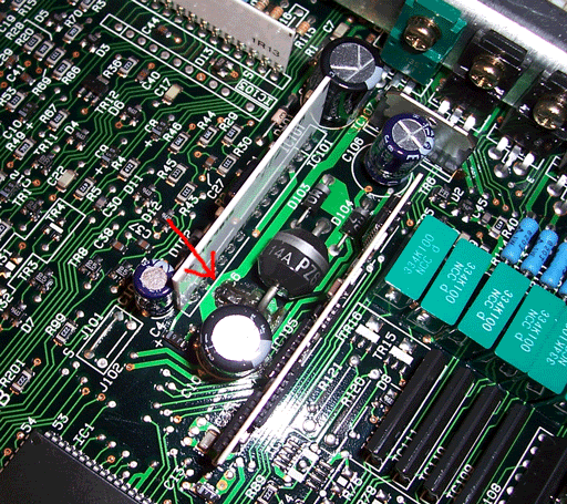

i have found the problem.
http://i5.photobucket.com/albums/y190/stealthmodifier/a1e5734c.gif
so i guess my 2 choices are send it in for a rebuilt or throw out 700 for a new one?

Polygon
06-28-2006, 10:57 PM
Damn CAPs!
Makes me glad that has already been taken care of on my R/T.
Wouldn't sending it out to have the CAPs redone be less? I know there are people on 3Si that do it for a descent price.

yea. i looked closely and the one at the top left has done the same damage as the bottom one. i found out just replacing the caps wont fix it since it ate up the circuit board. i might get the one off ebay that doesnt require a core.

check the FAQ. www. avpro.com

They are ridiculously fast. check their website, I think it's like 2-3 day turnaround, lifetime warranty for only $275 or so. If that doesn't work, you could try www.car-part.com and search for another ECU, I found one for me for $100 shipped, and then just buy replacement caps for $5, and ask somebody who knows what htey are doing to swap them for $20.
