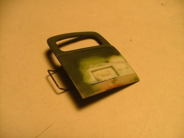

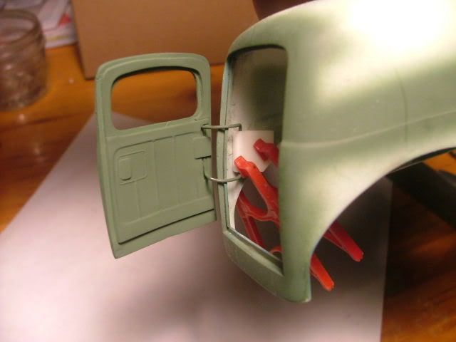

http://i9.photobucket.com/albums/a99/quadzero/rdoor.jpg
there was no door with this so I scrounged around and found this '53 chevy panel door.
http://i9.photobucket.com/albums/a99/quadzero/rdoorb.jpg
I glued scrap plastic on to the panel door here and there and shaped it with some sand paper and it fits pretty well.

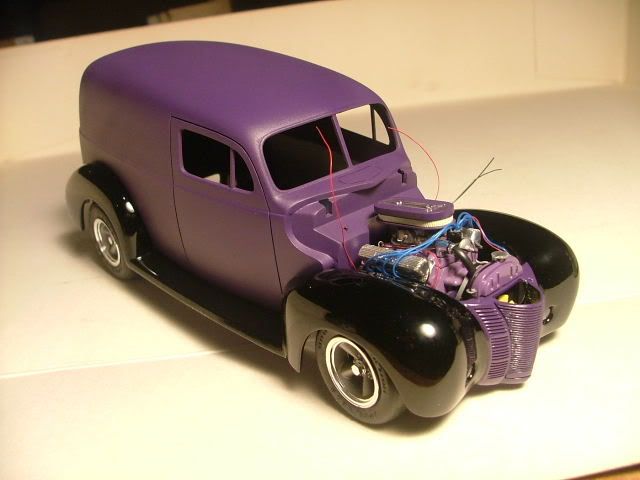

http://i9.photobucket.com/albums/a99/quadzero/mockup.jpg
here it is with most of the body modifications and repairs. I had no headlight bezels and I wanted to some body work too so I filled in the holes for the lights and tail lights. I sanded off all the body detail and re-scribed the panel lines and a new gas cap. I airbrushed on some scrap paint to show up defects and quite a few are showing. the roof repair went quite easily but the window strut in the middle took me over 2 hours to get to look right.
to fix the roof, I glued stretched spruce on the outside of the body matching the body contours. from the inside, I superglued small bits of plastic onto the spruce until no daylite was showing. then I sanded off the spruce and shaped with a small file and wetsanded until I had the shape I was looking for. like I said, it was easy and took about 20 minutes. scribing the windshield trim took a little longer but still was an easy procedure.

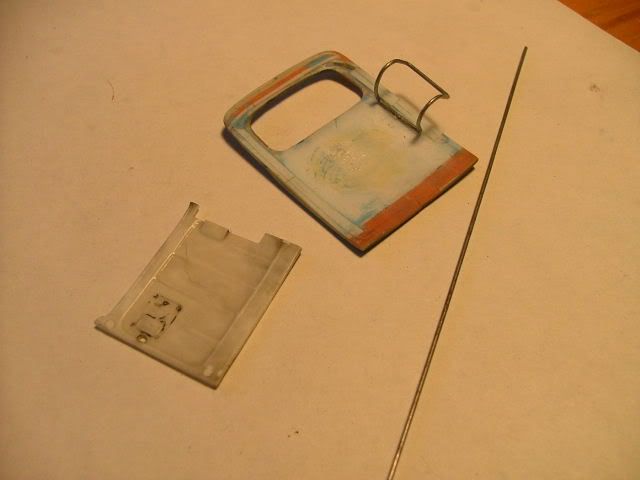

I had wanted to make the back door hinged but until today I wasn't sure if it was worth it or not. But I know in the future I would like to make hinges so I thought some experience wouldn't hurt.
http://i9.photobucket.com/albums/a99/quadzero/door1.jpg
Just the basic parts and my third attempt at the hinge using some thin rod.
http://i9.photobucket.com/albums/a99/quadzero/door2.jpg
From the start I wanted to make a recessed licence plate but only remembered about it after I assembled the door so some carefull carving was in order. (note to self- cut the hole first and then glue the panel on next time).
http://i9.photobucket.com/albums/a99/quadzero/door3.jpg
All together in mock up, the door doesnt swing as nicely as I had hoped because of the hinge. the door is too thick and no matter where I experimented with the hinge geometry, it would not swing out and away but instead binds abit with the body. To solve this I have a made a bit of slack in the clamped down part so at least it works but its kinda sloppy.
Now to clean up the door and smooth it all out and I'm ready to paint the body.
Thanks for the comments, gang.
Les

07-29-2006, 05:22 AM
Les,
I think you might find that the answer to your hinge problem is to put a "kink" or "U-bend" in the rod. If you can find my Dino thread somewhere, take a look at how I shaped the rod for that.
I can't promise it will solve your problem, but I think it might be worth trying before you get too far ahead.

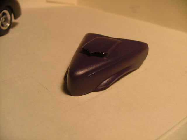

Well, fell a bit behind with the problem of the hood not closing. I thought if I shaved off enuff from the inside of it, I could clear the breather but it didn't work. So after a ton of trial and error with different shapes and sizes I came up with this. Please dont laugh:frown:.
http://i9.photobucket.com/albums/a99/quadzero/scoop.jpg
The top came from one of the interior door panels that I cut from the kit interior, which I thought might come in handy some day. It had just the right curve that I was looking for. It's not fully done yet but I shot some body colour on to better visualize the direction it was going. (I think it was heading for the Twilight Zone, to be honest)
http://i9.photobucket.com/albums/a99/quadzero/body4.jpg
And finally I have something that looks like a car, wohooo!
Thanks for looking,
Les

08-02-2006, 04:18 AM
This just gets better and better Les! Really, it's a jaw-dropper the way you are turning that negelected piece of styrene into a prize winner :thumbsup:

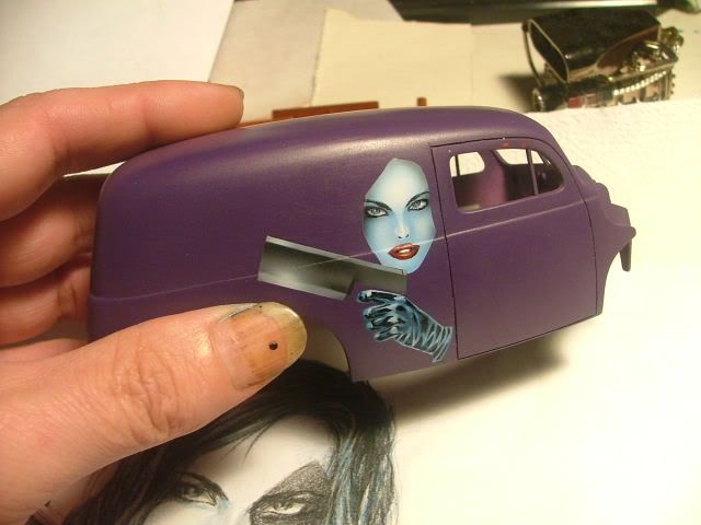

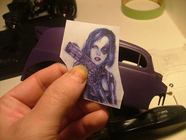

Well the only reason I took on this model was to see if I could try to do a mural. I dont really like them on cars but on this I think it would look pretty good.
http://i9.photobucket.com/albums/a99/quadzero/dominocard.jpg
This is my fav comic charactor and this is what I wanted to do from the start.
http://i9.photobucket.com/albums/a99/quadzero/dominosketch.jpg
I didnt want to go too small and wanted to concentrate on the face mostly so I made a few sketches and this is what I liked the most. It's just done quickly with pencil crayons.
http://i9.photobucket.com/albums/a99/quadzero/domino1.jpg
I reduced the image so I could get an idea for a precise placement on the body.
http://i9.photobucket.com/albums/a99/quadzero/domino2.jpg
This is where I am now, tons more work to go yet as I'm just "fleshing" it out now. I had planned to do a background too but it will just take too long.
Once I finish this side, I will look for ideas for the other side.
Thanks for looking.
Les

08-07-2006, 05:33 AM
Holy cow QuadzeroMan!!
Are you putting that on there freehand with your airbrush :eek:
Amazing skill...
I have to say that the original DC(?) Domino looks so mean she scares the s**t out of me but I'd like the phone number to your one! :lol:
Amazing skill...

http://www.redsresources.com/pics/domino.jpg
I'm anxious to see how this works out, I woulda been a wuss and just used a printed decal! :p
