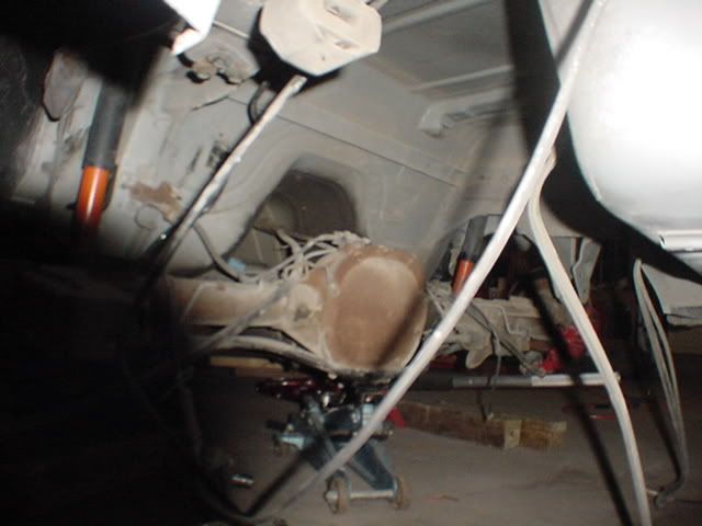

Now on to my previous question...Is there any way in hell to get this gas tank out without cutting my exhaust off. I've got everything undone and its ready to drop but i can't angle it out on the right side of the car far enough to completely drop it.

exhaust has to come out and have fun dropping the tank... it actually has to be angled front to back and then angled toward the front of the car to come out... it's one fun job.... you do have your rear dropped too right?

Well I reckon its gonna need a new pump in it anyway if the motor goes bad and i'd have to put a new motor in it anyway. But the gas tank is out and laying on the ground and i will NEVER do it again after this. I dropped my rear axle to the ground, my exhaust had to be cut off to make room for the tank to drop since the exhaust was welded all the way up to the engine, and now my chrome tips are scratched. I'll try and take some pics of it before i put it all back together. Its hard to work on a car with me having no mechanic experience, and being by myself with a full time job but i think i got this one day. Now to rebuild the motor i guess, sooner or later, and put a turbo on it :nutkick:
