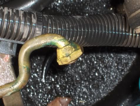

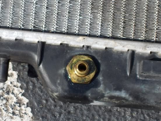

Well, I just wanted to follow up on my issues b/c I hate it when posters don't give updates which may help other members. :smokin:
A mechanic and I pressure tested the system for an hour and discovered the leak. I believe the leak existed before I bought it a few months ago. The coolant is pretty much baked on there. It was actually hard to find but as we increased the pressure the small leak turned into a steady stream. Also, after looking over the previous owner's records, the timing belt service was performed at a dealer at 75,000 miles. As is stands I will probably wait to do another timing service. I just replaced the radiator and flushed the cooling system.
http://img.photobucket.com/albums/v68/korean_teg/Picture008.jpg
http://img.photobucket.com/albums/v68/korean_teg/Picture011.jpg
