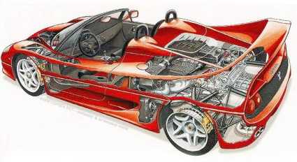

yea I guess so because Ferrari did something similar with the F50. You, know how the F50 only has two lateral ducts in front of the rear wheels?
Look at this pic
http://www.speedace.info/speedace_images/ferrari_f_50_cutaway_drawing.jpg
Its the same thing, there's a radiator placed infront of the intake, and the engine intake box is just over the radiator. But wouldn't that cause the F50's V12 to suck in hot ambient air? As for the Enzo wouldn't letting the air pass from the intake get rid of some of the ram air effect?

lol, yea they probably divided the upper intakes to give air to the air intake boxes and the smaller coolers as well. But the F50 im just lost. Because in that drawing the radiator's taking up the whole opening, and a 500 hp V12 can't breathe by sucking in ambient air from the engine bay

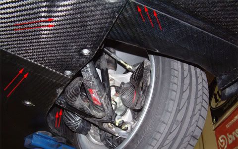

oo, because then thats the only way it makes sense. The huge upper intakes are for those smaller radiators, while the smaller lower intakes are ironically for the engine. But then again the McLaren's intake is a ram air intake placed on the roof, where there's tons of high pressure air flowing in to it. Because air going over the top of a car travels faster than it travels under the car. So maybe Ferrari found a way create a similar effect on the lower sides of the car in order to supply the engine with adequate air .As for the brake cooling, Ferrari probably did the same thing with the rear brakes as they did with the front, they used ducts mounted directly on the knuckle that would scoop the air from under the car to the rotors. But the F50, I have no clue where that car gets its air for the engine fom. Also, here's a pic of the Enzo's front brake ducting
