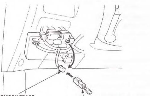

:screwy: I accidentally pulled my srs fuse out and after i put it back the srs light came on. I looked around the forum and found some instructions somewhere. this is how I reset my srs light:
There is a yellow plug under the dash that has two wires going into it. The plug is plugged into an empty socket by the fuse pannel. Take that plug out, place a jumper wire [i used a thin paperclip] into the two holes connecting the two. Turn the ignition key on (lights on, do not start). The SRS light will go off, within 4 seconds, unplug one side of the jumper wire [paperclip], when the SRS light comes back on, plug the jumper back in,(within 4 seconds) the light will blink twice and go out. Unplug the jumper and turn the ignition key off. Wait 15 seconds, then start your car. The memory will be reset. Replace the plug and you're set.
this also worked on my 92-95 generation but
its kinda hidden on the 96-00 model so here's a pic of which wire it is,
<img src="http://i21.photobucket.com/albums/b285/jag_312407/SRSFixture.jpg"; border="0"></a>
If the pic doesn't show, try this link: http://i21.photobucket.com/albums/b285/jag_312407/SRSFixture.jpg
This was really easy to do on my 95 but I had to try it like 5 times on my 99 civic before i got it to work so don't quit too soon :iceslolan
